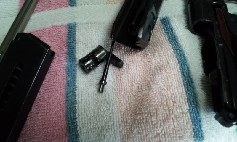

- Posts: 1409
Re: P-64 Slamfires
What I found is that yes, you can install the firing pin in wrong. It will go in with the nub facing down in the channel that is cut in the bottom of the slide. HOWEVER, the safety will not even function if this is the case. You seriously need to take the slide apart and look at your firing pin to see if it is broken. If everything checks out, then you've got some sort of freak accident that can't be reproduced.
Pictures:
Firing pin and Safety.
How they would be meshed together in FIRE position.
How they would be meshed together in SAFE position.
If your firing pin has the nub, there is no way it would go anywhere in SAFE.
Is there a spring on the firing pin? Is this the first time you've taken it out to shoot it? Let us know what condition your gun is in and these parts. Post pictures if you're able to.
Pictures:

Re: P-64 Slamfires
Thank you soo much guys! I took it the fireing pin out, and sure enough, broken right under the nub!
I was wondering how the hammer cam in contact with the fireing pin....in my case it couldn't.

Great call Junius!! I guess a firing pin could be broken like that for who knows how long and everythings works great until you go to use the decocker---.
- Posts: 1409
Re: P-64 Slamfires
No doubt fully machined! It could remain undetected until someone used the decocker, you wouldn't think anything different. SpinKiller someone on here had a listing in the Buy/Sell/Trade. He was selling some parts as a single lot for $40. One item was a firing pin. Otherwise, if you just want a firing pin, they run $25 + shipping on http://www.gunbroker.com. I am glad to have had a good suspicion.
I'm sure the firing pin sticks out a hair when on SAFE. Nothing that would really cause any alarm as the nub is supposed to keep the pin from moving. However, with the nub broken and the forward inertia of the hammer, it could more than likely force the firing pin to slam forward and strike a primer which was your case. I'm glad there were no injuries.
