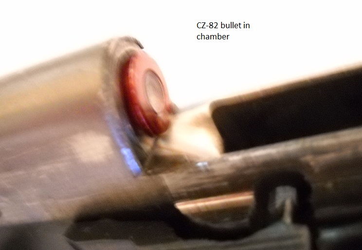

I post these two photos to show the difference between the P64 and the CZ82 with a cartridge in the chamber. Obviously, the P64 sticks out much more than the CZ 82

fully machined
Posts: 162
Re: Buldged Cases
Post by fully machined »
Does the bulging occure at 6'oclock, the feed ramp area? So what does the brass look like when fired out of a 82? Wow, it is sticking out!!!!
wolfstein
Posts: 20
Joined: June 4th, 2012, 8:43 pm
Re: Buldged Cases
Post by wolfstein »
Can't tell if it bulges at 6'oclock when it ejects. Does not bulge when shot from the CZ-82.
Re: Buldged Cases
The ramp area on the P-64 is unsupported and these weak PPU cases are bulging in this area. Steel doesn't have this problem as it's steel. Starline brass doesn't have this problem from what others are saying that use Starline brass and my Luger cut-down brass has never bulged either.
