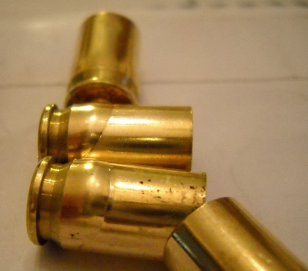

I was at the range yesterday shooting my P64 and also experienced bulging cases. The gun shoots without any problems. I was using PPU ammunition, 93 grains FMJ, made in Serbia. Not bimetal and brass cases.
- Posts: 1408
Re: Buldged Cases
That looks horrible. Definitely sounds like really soft brass. Kind of a waste of brass. ![Sad :(](./images/smilies/icon_sad.gif)

The ramp area on the P-64 is unsupported and these weak PPU cases are bulging in this area. Steel doesn't have this problem as it's steel. Starline brass doesn't have this problem from what others are saying that use Starline brass and my Luger cut-down brass has never bulged either.
