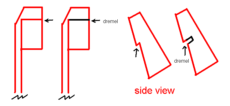

I figured out the official Polish armorer solution to this issue. My '75 had had it done.
I can't get a picture of it, so I drew a picture. This is part #21, the trigger bar, specifically the face of it where it contacts the bottom of the hammer. The black parts indicate where the ledge was dremeled in, approximately 1.5mm additional. This gun operates correctly in double action mode, cocking the hammer back about 2/3 of the way.

Re: Won't fire double action.
Hardcore Keith, have you tried performing this modification to the gun that wouldn't fire in double action, and did it work?
Fred
