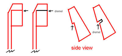

After a lot of study, it seems the issue is that the trigger bar and hammer are both worn down at the spots where they contact each other. The trigger bar has a little ledge on it that hooks onto the bottom of the hammer. At some point when it's rotated sufficiently far in double action mode the hammer slips off the ledge on the trigger bar and is released. Both that ledge and the hook on the hammer itself have worn down such that it slips off much earlier than it should, resulting in pathetic primer strikes in DA mode.
I'm afraid I may have to try to send that one back to SOG.

thanks for you posting this any pix
