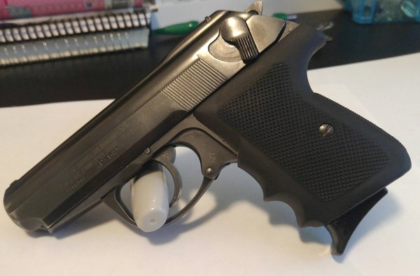

Hello!
Proud new owner of a 1974 P-64 from AIM Surplus.
I am planning on fully cleaning my P64 - I just am not sure how far to tear it down. I was thinking of removing the grips, slide, and magazine, and the firing pin. But aside from that - should I break it down further?
I have the Iron Grips V.05 and wolff 18 and 19 hammer springs, firing pin spring, and 22Lb. recoil spring.
My plan is to clean it and lube it and shoot it stock for a while, just to break it in/feel it out - I might change the grip soon, but I wanted to try it with stock springs and see.
What else should I do? Any advice from folks on any of this? Anything that I forgot?
