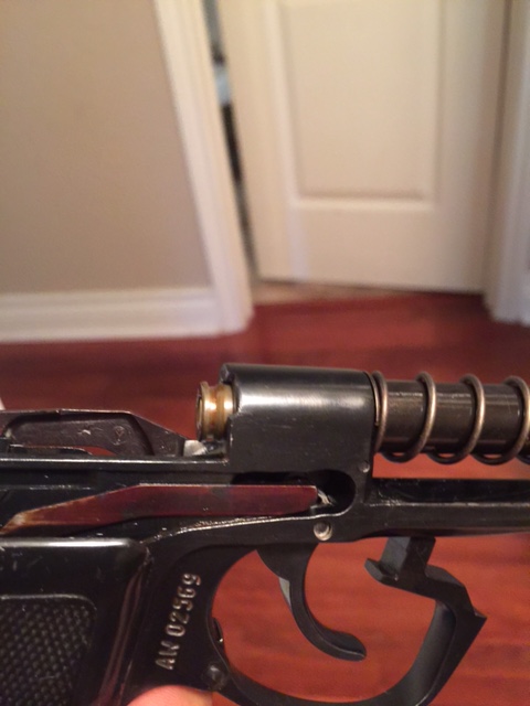

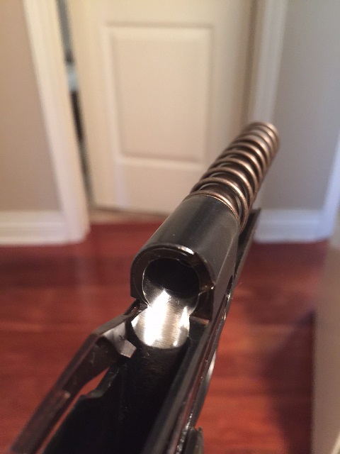

I am a new member and new P64 owner. I brought my gun home yesterday, cleaned it up and polished up the feed ramp. I dropped a round (brown bear, steel case) in the chamber while the gun was disassembled to check the seating and something didn't seem right. I noticed that the round stuck out a little bit more that what I'm used to seeing with my other auto handguns. Is this normal with this gun? I have attached some pics of what I'm seeing. Any help / advice with this will be greatly appreciated.

I just went and stuck a 'Bear' in one of my P-64s and you're really close. My cartridge went in so the upper (right/hand) side of the groove was even with the chamber housing. Yours looks like it might be 1/32 or so of an inch more stuck out? Feed ramp looks polished (!!!) but did you do the chamber? Might be a lacquer build-up from shooting the older steel-case ammo which was coated with it. A gift from the Europeans to you! :mrgreen: Cleaning might take care of that.

I did polish the feed ramp. I probably went in the chamber a little as well. I was always taught that a nicely polished feed ramp is good for chambing with semi autos. Maybe not so with these older guns. Now I wish didn't polish it. I still haven't fired it yet. Probably will tomorrow. Hope I didn't screw up a perfectly good gun. Thanks so much for replying and the advice!

Looks pretty close to me, but it's hard to tell by photo.
Get a snap cap or build an inert and test. Feed the snap in from the magazine. Make sure that the slide closes all the way and that the trigger will engage, which means that the Out of Battery disconnector isn't preventing use due to the slide not being in battery.

I don't think you caused any problems with a little polishing.

I , too, polished my feed ramps. I think it is a good idea and hope you didn't think I was implying that that was a problem. It's just so shiny! You did a heckuva job but I wondered if you had done a good cleaning inside the chamber as there have been a few reports of problems caused feeding AND extracting due to lacquer buildup from using the old steel-cased ammo. If not, do the chamber, too, and see if that gives you what you need.

I looked at mine. It is possible yours is just a tad off. Just see if you do have a build up in the chamber. Be careful and point down range when go to shoot it. Hope it works out.
