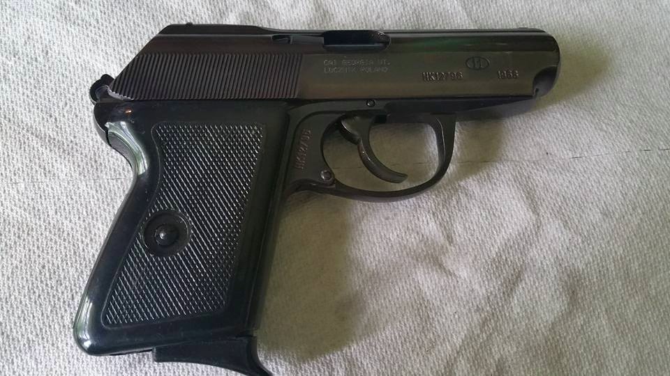

Got mine, oh about 2 months ago now. It has been problematic. First time out shooting, after the last shot, the slide locked open, but when I say locked, I mean LOCKED. The slide lock arm was getting jammed between the bolt face and slide housing. Was getting chewed up in the process. Took herculean strength to get it worked loose. Then it would lock up again after the next mag. And I had one incident of fail to fire. Full pull of trigger, no bang. So I've replaced:
  • Slide stop lever
    Slide stop spring
    Recoil spring (18 lbs)
    Firing pin spring
    Hammer spring (18 lbs)
    Magazine spring (x2)
Got most of the above items from Wolff Springs and the fellow on Gunbroker from Poland (laukert). I had my fears, but he's legit. Got my stuff in great condition, although, I kid you not, the package arrived in New York, then went to HAWAII! Then on to the midwest where I got it. USPS :roll:
Haven't had it out yet since these mods installed. I'm not put out by all this, my pistol has seen heavy use and the condition reflects it. It's been interesting getting it back up to shooting condition.
I do kind of like the patina on my pistol. It is very brown, not black at all like most of the others I've seen. So I guess I'm willing to put up with her quirks because of her looks. :wink:

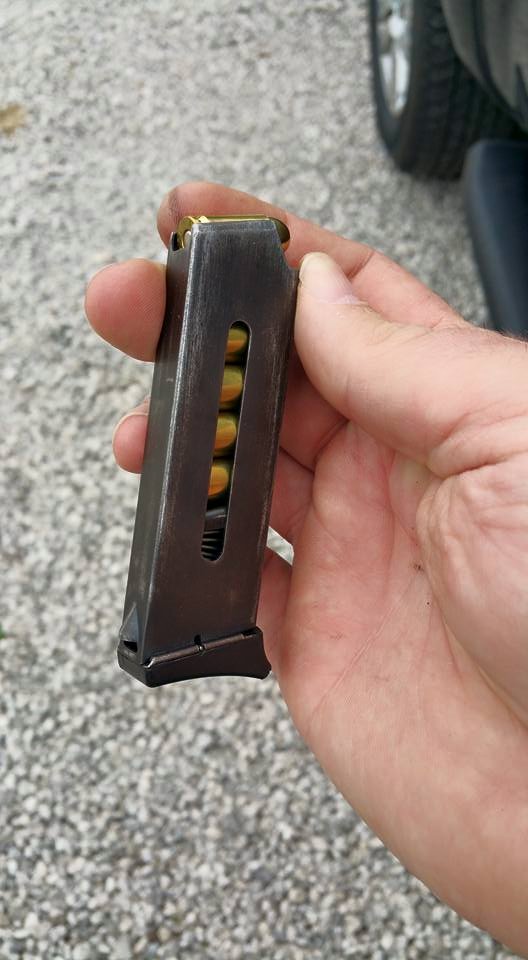

robhic, I'm glad to see someone had the same problem as me! Took a brief trip to the range today. First mag went off flawlessly, to my relief. The second mag after the 6th round didn't lock back, and when I inspected it, the mag was sliding out. So I put in a new mag and racked it. Pull trigger, no bang. I found when I racked it, I put the safety on (I'm a lefty, so my right thumb can actuate the safety if I'm not paying attention). Take it off safe, bang bang bang bang bang bang, end with slide locked open, all normal. Reload my three mags, all perform ok, except I get another failure to lock slide after last round with the mag falling out again. It was the same mag as before, one I refer to as "chippy," as the finger rest is chipped. Well I load that mag up again, insert it and make certain it is seated. 6 bangs later, the slide locks open as it should. I think maybe this mag requires a little extra omph to insert and seat, as it is an old warhorse.
So I think the function of the pistol is up to snuff now. The pictured target was at 10 yards and I wasn't really aiming carefully, as I was snapping off rounds quickly to check reliability. Despite that, I'm pretty pleased with the accuracy. And those makarov rounds have a nice little kick don't they? I was shooting Fiocchi 95 grain, but at the end shot a magful of Hornady critical defense 95 gr. Those actually had a lot less recoil, very noticeable.

Robert, I replaced the slide stop lever completely. That seemed to do the trick for me. That, and the magazine springs. Is it possible you have a mag with a really weak spring and it doesn't overcome the resistance of the slide lock lever spring? If that lever doesn't come all the way up and fully engage the bolt face, it can slip off and that's when it's getting bound up between the frame and the slide.

I looked around for a new lever and couldn't find any except one guy on Gun Broker who has a $60 parts kit that I don't really want. The locking takes place with any magazine of 5 used so I don't think that's an issue. Those mags work in the other pistols. When I look in with a light, the lever is up all the way, and resting against the outer edge of the bolt face. I've decided any grinding is OUT!
