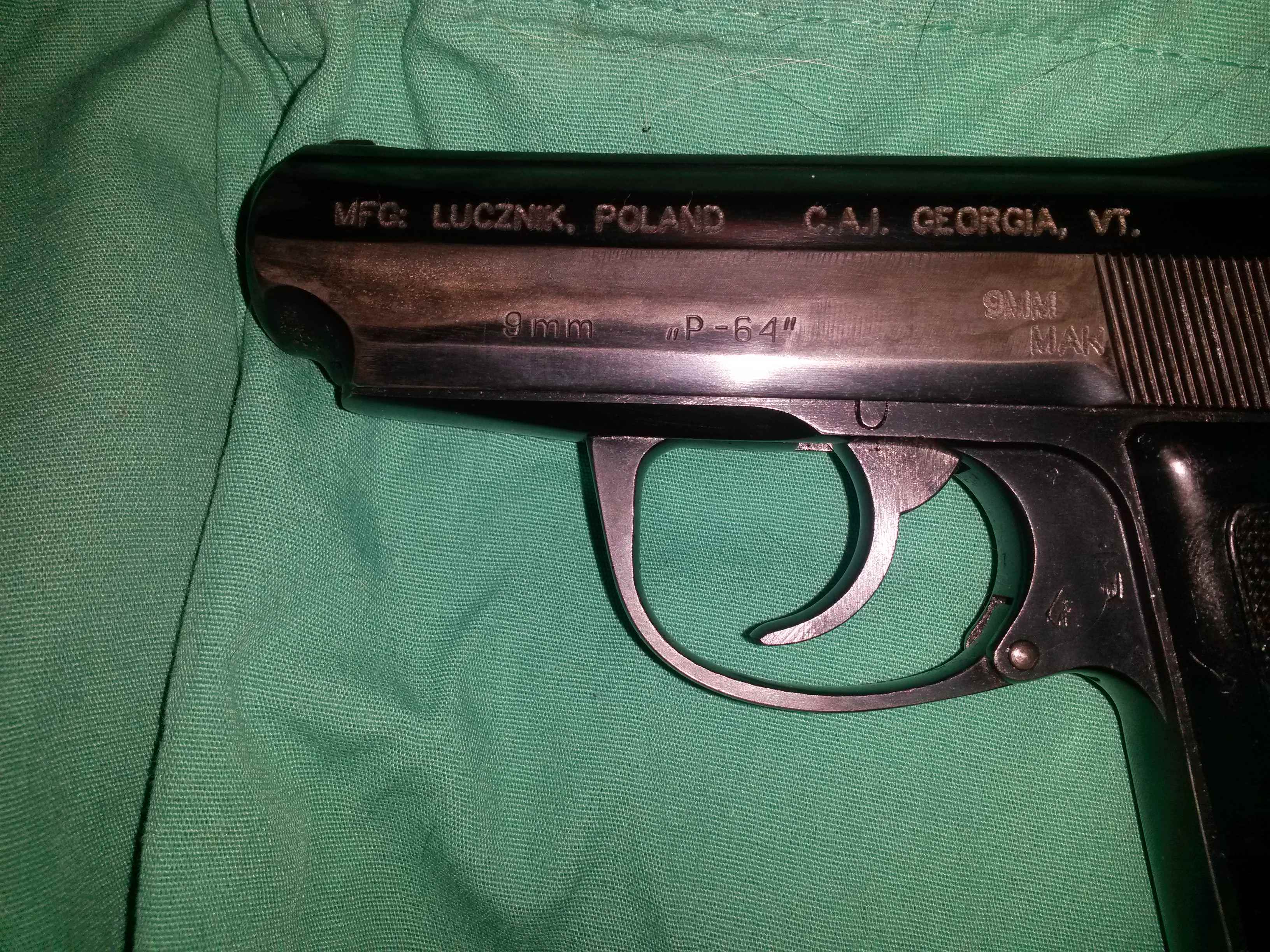

I recently got my P-64 from J&G, and I'm a little curious about something- what was on the left side of the slide that was ground off? Seems like someone took a grinding wheel to mine, I can still see the original 9mm "P 64", but it appears that there was something else above it, along the flat facing. Something that somebody went to a lot of effort to remove. When I look, it sure looks like the entire rest of the slide was erased with a sander, to the point that you almost feel a wave in the metal with your fingertip.
Was there a crest or something, maybe related to the Soviet era, that the Poles decided to remove?

ok, using google, I can see what it was... another pistol shows a different import mark. The picture I see shows a mark from PW ARMS REDMOND WA, in the same area... mine is buffed in a brutal way there (assuming they removed that mark). Mine has CAI on the curved upper contour... :cry:

That sucks. Is it now bare metal? I've never seen on like that. Can you post a pic?

I'd send it back, or demand a new slide from them. They are required by law (I think) to put an import stamp on the side of the slide.
Re: question about the slide
+1 I would get them to replace it.

Hi, sorry about the late reply, been busy working and dealing with car issues (and stumbling across a deal on a IJ70 AH). As you can see, the left side of the slide is practically bare metal; with some markings from a grinder or sander. The right side looks fine. In regular light, it wasn't immediately noticeable, I think it may have had some cold blue added so it wasn't "white". The CAI markings are very rough to the touch, and the flat side seems pretty smooth.
Gun works fine, shoots fine; and I think it's a little late for me to try to fight with J&G this far down the road. I might try my hand on polishing it as best I can, then trying out the "drain cleaner" hot blue
http://bbs.homeshopmachinist.net/thread ... tic-bluing
I've been intrigued by the rebluing, it really seems to come out well. I've just needed a test subject :lol:, and this would be a "slide only" job. If it works, I have 3 older pistols that could benefit from being reblued (and lack any collector value); an older Norinco T-54, a H&R 999 Sportsman, and a High Standard Sport King.

I would not be happy with what they sent either.

I agree. That just don't look right.
