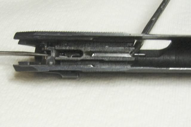

Thanks for the comments. The Wolff springs came in today. I replaced the firing pin spring that came with the recoil spring. 'm trying to put the safety back into place but I absolutely cannot keep the safety detent & spring pushed in and push the safety over. ??? Is there some trick? I have used everything from a modified screwdriver, 1/32 punch, fininshing nail, and even a bent paperclip. I can't figure out how to keep the detent pushed down and slide the safety back over. Anyway other than that it's going well.

Yeah, it's tough. After you get the edge of the safety axle pushed in just far enough to hold the firing pin, turn the safety enough to have the relief towards the back of the pistol, and use the blade of a small, flat screwdriver to keep the safety straight with the hole, not allowing the firing pin spring to cant it. The screwdriver will be coming in straight from the back. Then, compress the plunger into it's hole with a small punch and wiggle the screwdriver lightly against the inside of the slide body so that it edges the safety over the plunger and into its final position. The secret is to keep the safety axle straight with the hole so it won't bind as you go by the firing pin and the safety plunger before it finally snaps into place.
If you can look again at the illustrations that TTH posted, with these hints in mind, maybe it will help.

push firing pin all the forward clip hemostats on the firing pin then you can turn the safety anyway you want

I got mine in...somehow...I really can't remember what I did, I was apparently in a blind rage when I finally got it back in.
