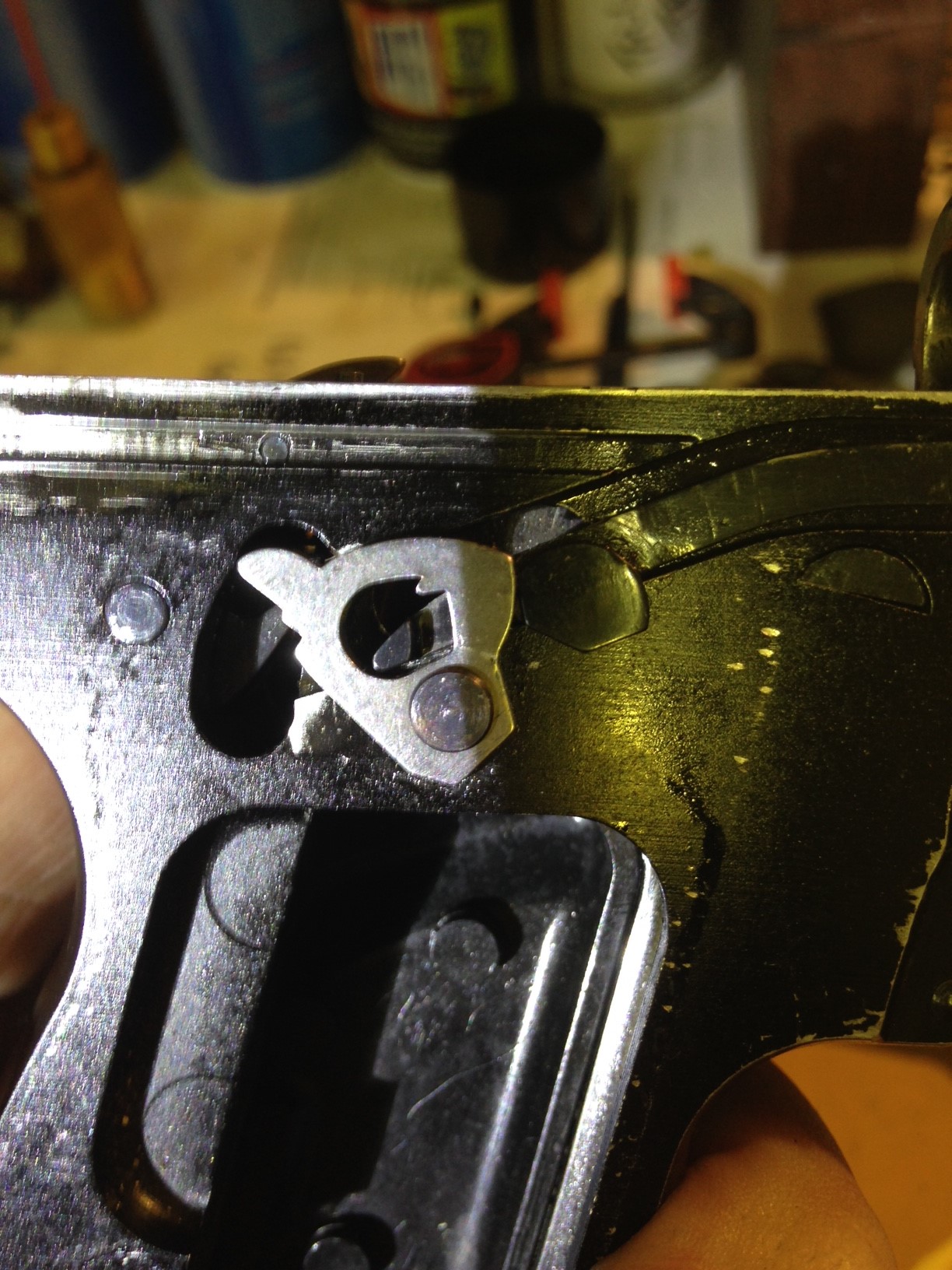

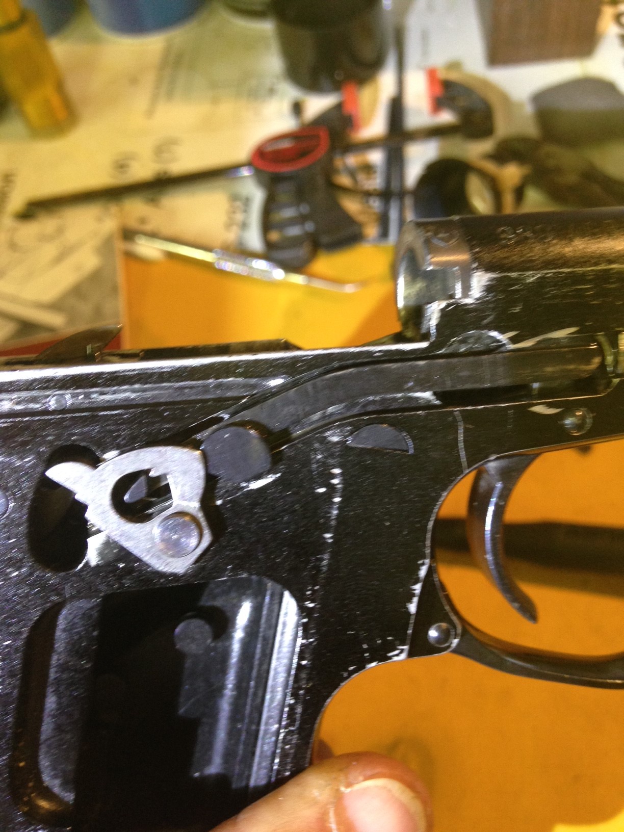

Ok after losing the site on my computer, I am back with pics of my TB and Sear. In one the bar is down and won't release hammer when trigger is pulled and in the other I have positioned it up in it's slot so it will catch sear high lobe and fire the gun. It just defaults to the low position and won't release hammer.
Re: FEG SMC 380 JUST STOPPED FIRING!!
In the first picture, is the hammer cocked? If not, the tab on the cocking lever/sear should be parallel to the frame and resting on the bottom spur of the hammer. You have to look inside the slot on the in front of the hammer pin. Also make sure that the front of the TB is fully inserted into the trigger.
Another thing. Cock the hammer and look at the bottom of the TB and see if the trigger spring is attached on the bottom of it. It's the silver piece that you see in this picture. When you cock the hammer the TB rises
Whoops that spring is not there. Must be as thin as the one on the slide lock. Can't be too hard to install one. Got a recommendation on where to obtain?
numrich has them for the PA-63 which should be identical. $7.00.
