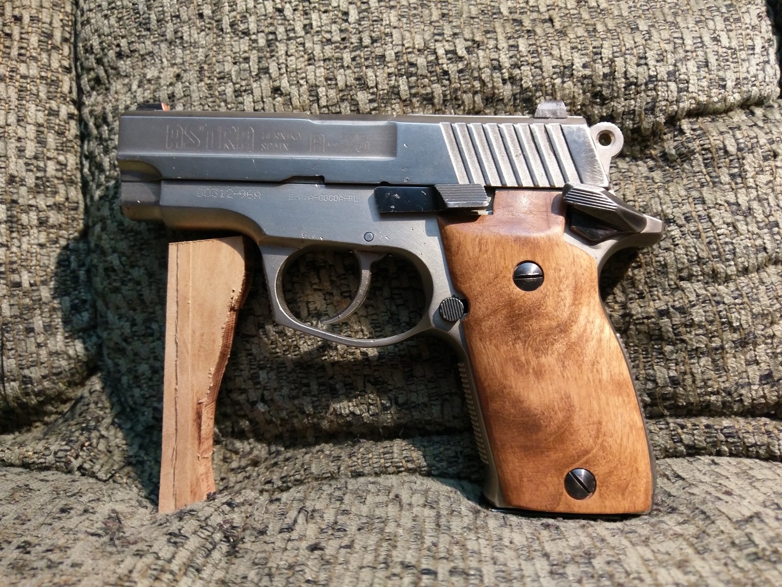

Ok, was trolling my old posts and realized I had never posted pics of my new / old Astra A75. Well, here it is. I just finished making the grips for it, they are Cherry wood with a custom blended stain. I love the way this gun carry's and shoots. if you get the chance to own one, do not hesitate, you will not be sorry. Not real crazy about "shiny pistols" so I am looking to have this one coated with either Duracoat or Cerecoat, not sure which yet.

Re: Astra A75
Another nice pair of grips!
Re: Astra A75
I just like wood grips on a pistol, adds character.
