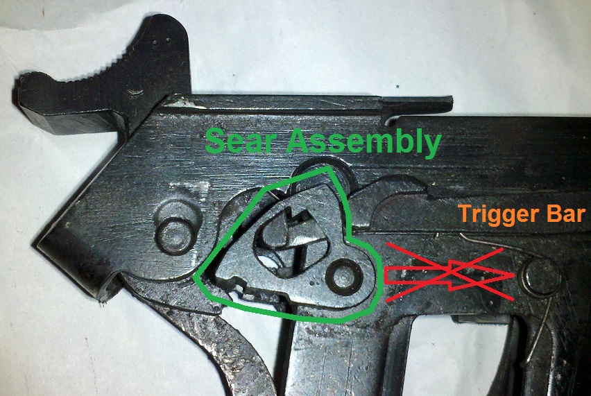

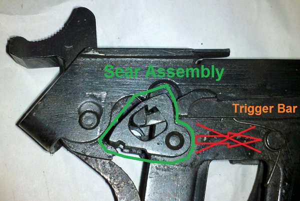

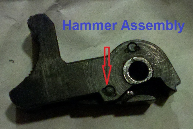

a) In the Manual it calls the part attached to the Hammer the Sear(31) I don't think this is what you replaced as I know that it's pinned in there. So let's agree to call the entire thing (25, 27, 31-33) the Hammer Assembly, as seen in the picture (ignore red arrows in both pics). b) Also part 24 is more of a Sear in my mind. So let's call that set (21-24) the Sear Assembly, as seen in the other picture.
Now lets step back and look at how the whole thing functions in the Frame. For this I'd like you to take the Grips and Slide off, and observe the Frame function only. A) When you cock the Hammer Assembly it should engage the Sear Assembly. At the same time you should see that the Trigger Bar is engaged with the Sear Assembly. B) When you pull the Trigger you will see the Trigger Bar disengage the Sear Assembly from the Hammer Assembly. If this happens you know that both Assemblys are functioning. If it does not then we need to diagnose those two Assemblys with a follow up. C) Repeat (A), then push slightly (maybe less than a millimeter) on the Disconnector, stop when you feel a change in tension. You should see the Trigger Bar be pushed down out of where it could function with the Sear Assembly. D) Next fully push on the Disconnector past that change in tension. You should now see (C) then the Sear Assembly disengaged from the Hammer Assembly, allowing the Hammer Assembly to fall. If (C) or (D) do happen then move on, taking note of exactly the small amounts of movement that engage/disengage what parts (this will be key). If (C) or (D) do not happen then we need to diagnose how the Disconnector is functioning.

a) In the Manual it calls the part attached to the Hammer the Sear(31) I don't think this is what you replaced as I know that it's pinned in there. So let's agree to call the entire thing (25, 27, 31-33) the Hammer Assembly, as seen in the picture (ignore red arrows in both pics). AGREED
