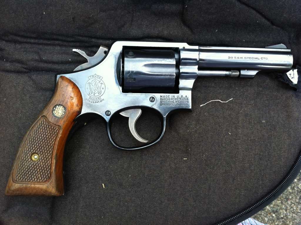

I have an opportunity to buy this. I believe it to be a Model 10 made in 1970. It's a .38 and lockup is tight. Some holster wear. My elderly neighbor offered to sell it to me for $25! What should I offer?

Well, I wasn't really looking to buy anything. He brought it out with a few others to show me and I could tell he didn't have any connection with it. I offered to take him shooting and the idea didn't do anything for him. He said it just sat around and collected dust, so my knee jerk reaction was "well, if you ever decide to sell it, keep me in mind."
I gave him some cash and brought it into the stable tonight. He gave me a box of 50 that I swear are as old as the gun. He felt like I was giving too much money for it and it made him feel a little uncomfortable, so I was good with it. I don't think he's strapped, but he's definitely happy to walk away with cash and to rid himself of a blued paperweight.
So anywho...
I've got a 1970 Model 10-6 that needs a bath and some range time. Can anyone tell me if there are things I should be doing/checking before wringing this thing out?
So anywho...

I had an opportunity to put a few downrange and this little guy is a keeper! I knew it would be a soft shooter, but had no idea it was going to be so accurate. This one isn't going anywhere! Thanks for the tips, guys!
