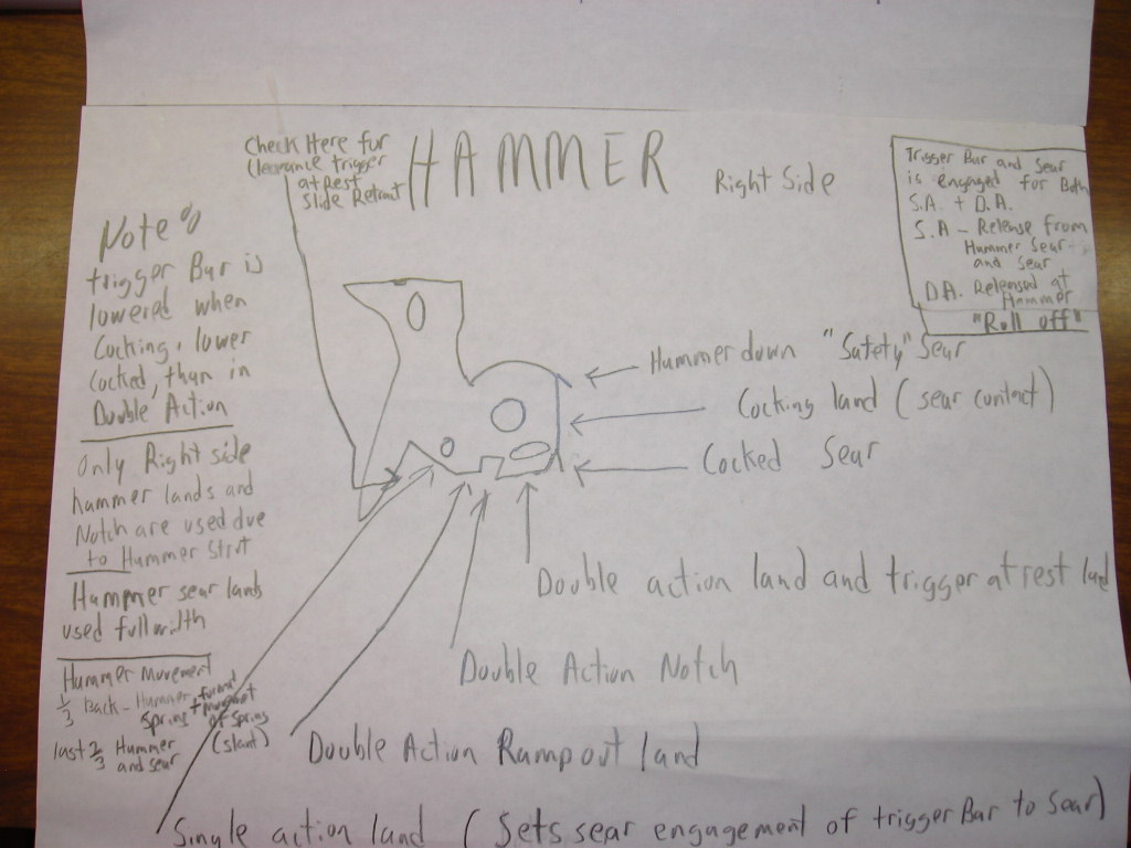

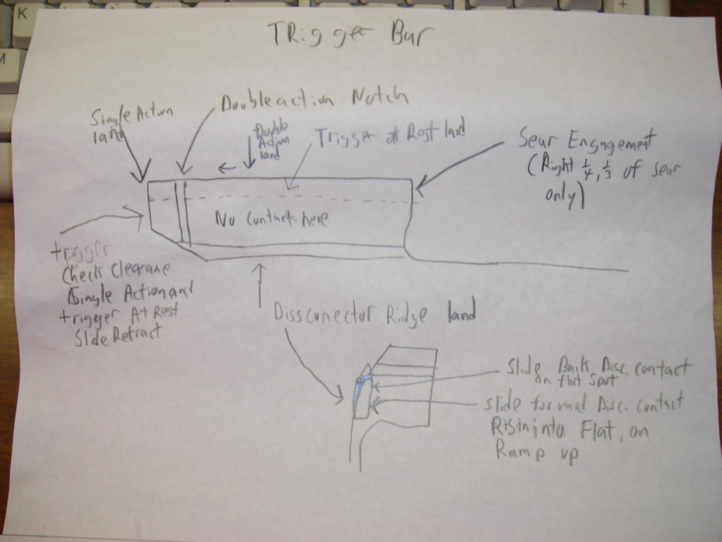

I thought I would share this--Please do not ask me to read my own writing !!!

I don't get it, what are you sharing??
No offense, but actual diagrams are available I think.

I was hoping to add to the wealth of info here. All of the diagrams I have seen are in Polish and do not have as many notes concerning function. Members refer back to old info here, so maybe one day someone could use this.

I can read Polish, so it hasn't been a problem for me
