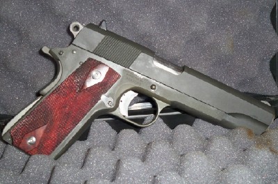

Well, I got it this morning and I would say it is excellent! I thought I would post a pic for y'all.
I do have a question, or two. On dis-assembly I accidentally dropped the spring and plug. I didn't get to see which end of the spring went where. One end has a "closed loop," the other end has an open loop(like maybe it's been cut?) Which end goes on first?
auto ordinance 1911
auto ordinance 1911
Posts: 1882
Re: Auto Ordnance 1911A1
Nice gun! The closed end goes on first. The open end fits into the plug.
