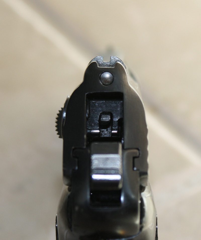

They had two P64s on hand, one of which seemed to be in just slightly better condition than the other, and neither appeared to have any problems. After getting it home and looking at it more closely, I noticed that the safety, whether on or off, seems to slope slightly to the right when viewed from the rear:
I took the safety, detent, spring, and firing pin out to make sure there was no crud hiding and to be sure all surfaces were OK. After re-assembling the safety mechanism the 'cant' is still present. There doesn't seem to be any functional problem with the weapon and when testing with a pencil down the barrel the firing pin is making rather epic contact.

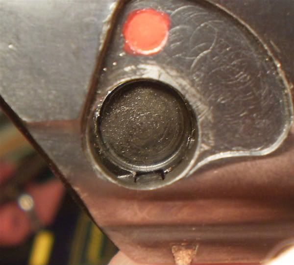

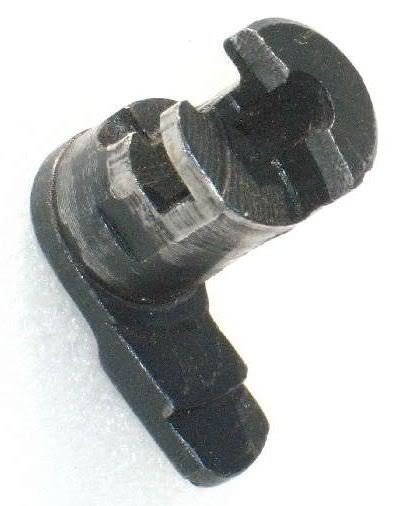

This is kind of strange looking. You may go back to Gander Mtn and ask to look at the other one to compare them. Like you said, you have a 30 day trade-out. I'll check my slide out, but I don't recall mine having a cant. I'll let you know. Your safety was complete you said, it didn't appear to have a piece broke off on the end opposite the thumb lever like this?

Thanks for the pic of the broken safety. My safety is still intact and that particular piece is not broken off. I just pulled the slide off and took a peek in it to double check. Didn't remove the safety again because my fingers aren't recovered from putting it back together last night.

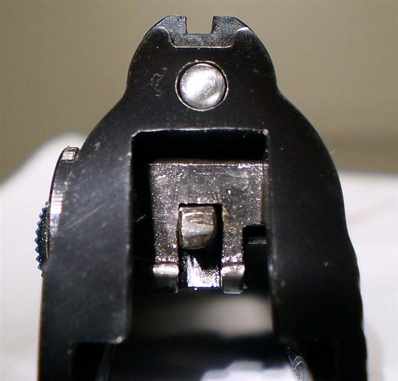

Mine appears to be pretty square. I wonder if your safety slot on the inside of the slide was milled out at an angle. Might have not been in the jig right or something when it was made. However, one of the other folks on here might have a different opinion.

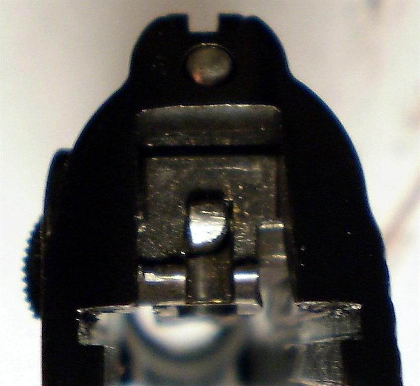

Mine looks the same. After inspection, it looks as if the cutout in the rear of the slide is misaligned and may be giving it the illusion of a crooked safety. I think the safety is straight - you can see the slope going up to the top right in the cut of the slide. Junius's cutout is definitely more square than ours.

dfunk your cutout sure does have a slight angle.
Rick's slide seems to have a good square cutout. The angle of the slide in the picture isn't quite true, it's a bit off-centered. However, with guestimation it seems to have a good square channel.

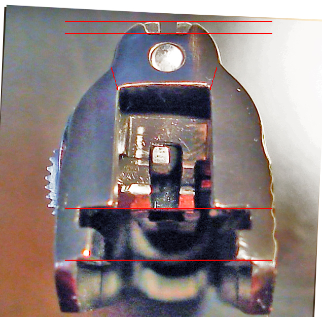

Yeah, after lightening the OP's photo more to see if I could get a baseline of alignment, I also think it has a slight cant on it. Without a better photo, this is what I came up with

Great photos Dick!
I rest my case,
Boomer

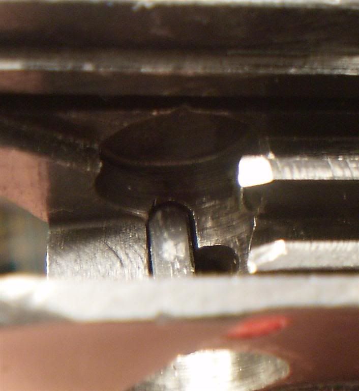

Rick, glad to hear you are satisfied with it being the milling of the slide on the back. Here are a couple pictures of the inside of mine. You can compare them with yours if you want to. Of course, you'll have to remove your safety to do so.
