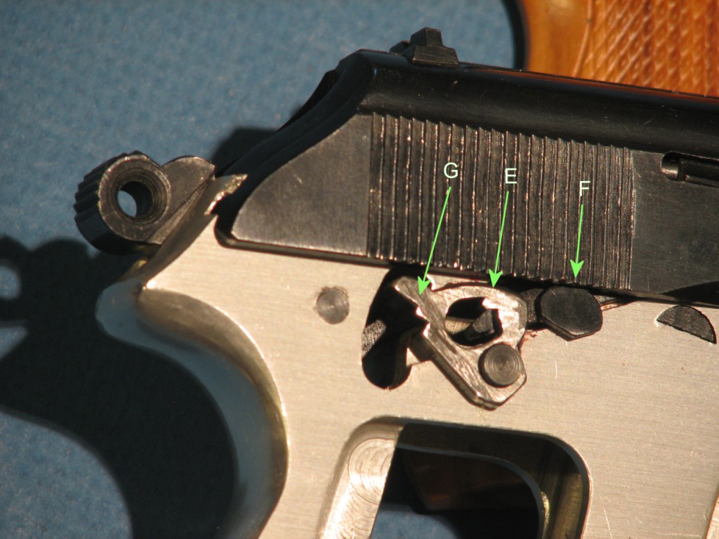

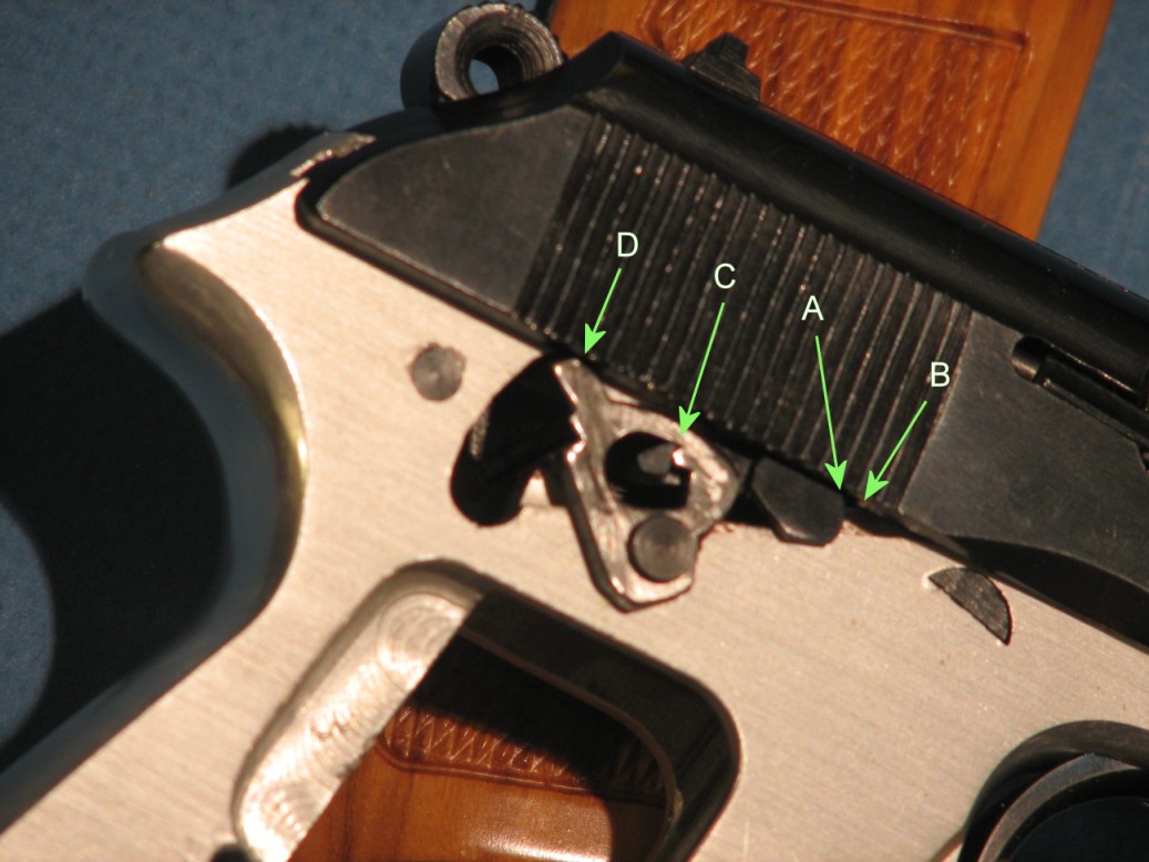

I took my PA-63 out and after some experimentation I was able to have it fail to recock. This will not occur normally, the interrupter/disconnector (F) must fail to move the trigger bar out of the sear notch (C).
Take the grips off and try this someplace where you can find the sear pins if they fall out.
Pull the trigger, keep the trigger held to the rear. With your other hand cycle the slide.
When everything works it will look like (G, E, F). If the trigger bar hasn't been pushed out of the notch check to be sure that there is an interference at (A), (B).
If the trigger bar is out be sure the sear has moved from (D) to (G). If the sear didn't move take the slide off and pull the trigger and watch for piece 6 to move up and down with the trigger movement from the center of piece 8. If you don't see that take out pin 9 and find our why.
