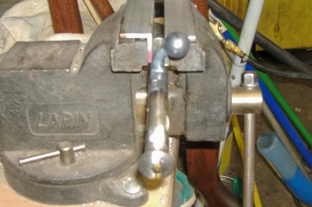

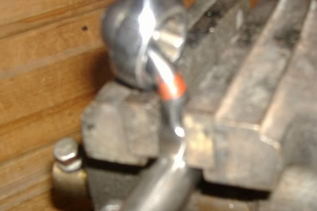

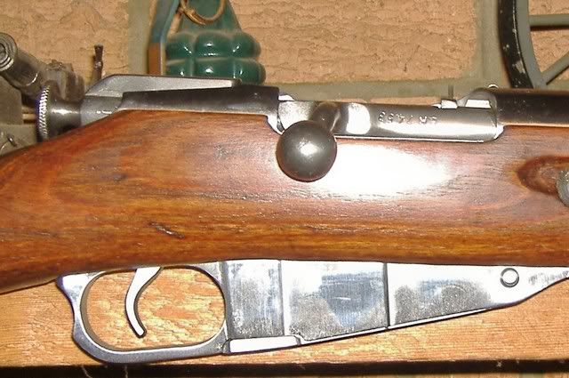

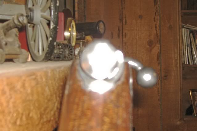

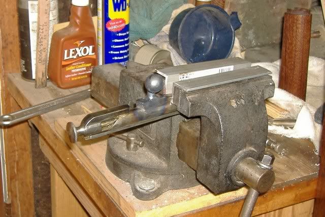

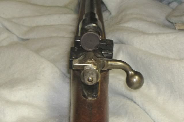

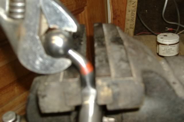

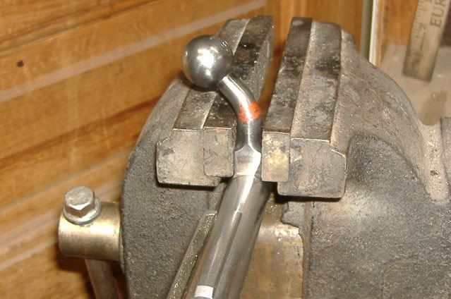

bending Mauser bolts not a problem , if you got a good vice, torch, and 10 in crescent wrench
I have bent plenty of them and Carcano bolts too
I bent the bolts top 2 Mauser hope you can see
will not a good pix
but it can be done , Mauser bolts are easy
better pix

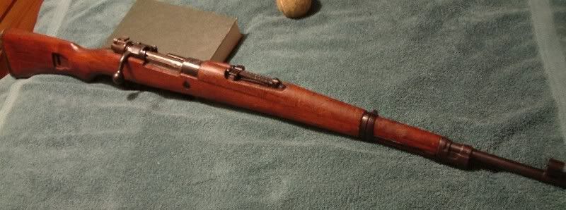

I've got a couple of great M48 and M48A Mausers, the M48A being shooter grade with a great bore and crown, the M48 being mint with matching numbers, bayonet with matching numbered frog and scabbard, two-bay brass oil can, cleaning rod and kit, muzzle guard and sight hood, complete. I'm going to put one or two pictures here to save band but give some new members or new surplus appreciaters a convenient reference:
Mint
Shooter
There are several more images of these Mausers somewhere on this forum. This massive bolt and receiver design and the incredible steel and fit and finish on these handy little 8mm battle rifles made in the fifties in Serbia, (then a part of Yugoslavia; in a German-built factory on German tooling from German design, as I understand it)make this a real favorite of shooters. I'm surprised you can still find an M48. I don't think you will find excellent and above anywhere with out spending a few hundred dollars. Mines not for sale. The greatest ammo for these is that Romainian, especially the mid-seventies ('75, '76) and the Wolf Gold Performance 8mm Mauser SP. Both are very accurate out of my shooter. I'd get an M48 or M48A if in good shape, and an M47 straight bolt in a close second.

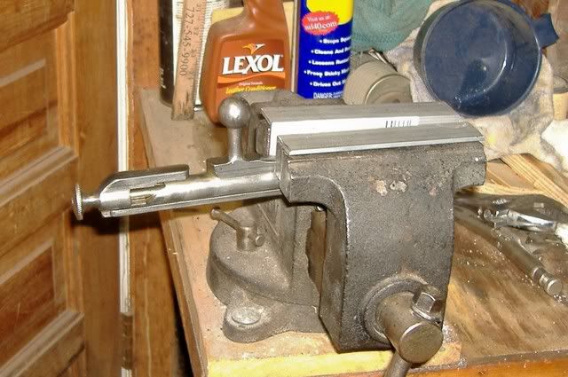

first take bolt apart
then lock it up in the vise on the flats of the bolt
heat bolt up too a glowing red all the around just in the spot that's mark in red while your doing this take a wrench and bend down
let cool, buff the blue off ,put bolt back together
