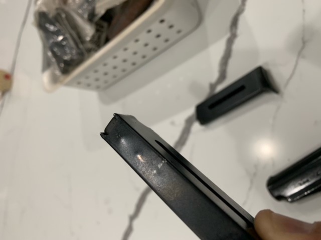

Hi, I'm new to this forum, but thanks for creating it. I hope I'm not posting something that has been discussed and resolved before, but a preliminary search did not find this subject covered. I have a P-64 that deforms the magazine slowly but surely to the point where it jams in the handle. The magazines start out perfectly smooth on all sides, but get small bumps near the back/brass side of the bullets that protrude further and further until I can no longer use the magazine. It will appear wavy where it was smooth after just 100 rounds. Is this normal? What's causing the deformation? Is there any way to salvage the magazines?

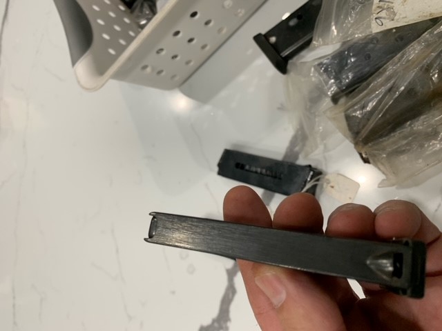

See attached... I haven't had this piece very long. It came with some other magazines that may be OEM, but they are too long (7 round).
Thanks!
Good
Good
Bad
Bad

Does the mag stick out farther than other mags in the pistol? and it looks like the dents are sticking out from the magazine? Or are they being pressed INTO the magazine?
