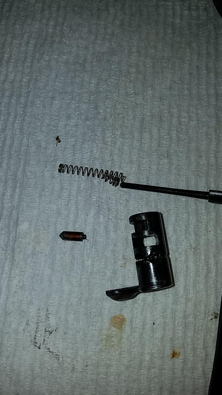

Re: P83 Firing pin and decocker issues
Post by gman68w »
To satisfy your curiousity, here's a photo of what I found inside. The pin spring did snap and had collapsed on itself. I'm pointing to it with the intact firing pin. I'm concerned about there being only one detent. I could've sworn there's supposed to be two.
Well at least now you know for sure what the firing pin problem was, easy / cheap to fix too.
I am not familiar with the P83 safety setup so I do not know if there is only 1 detent, although I would suspect only 1. And nice to know the FP is not broken.
