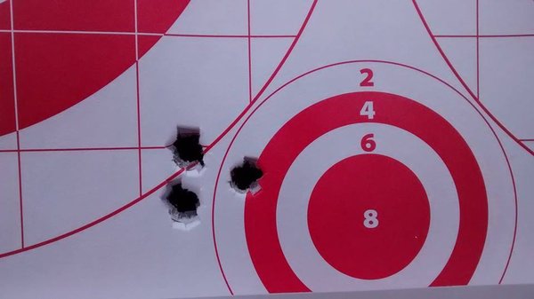

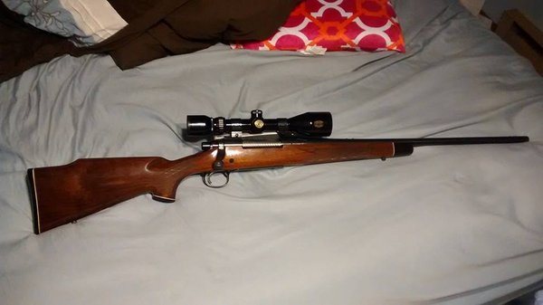

I've been going back and forth on what kind of load to use in my Remington 700 BDL .270 Win. I bought some Hornady 130gr SST bullets earlier this year as that's what I plan on shooting from it. I had some 130gr Federal Power-Shok that I bought from Walmart when I first bought the rifle from the older gentleman I bought it from. He said it was a good shooter (most folks say that when trying to sell a gun). However, when I took it to the 100 yd range with those Power-Shoks, I was very impressed. 3-shot group from a cold barrel was 5/8". The previous owner wasn't lying to me when he said it could shoot.

This was the 3-shot group with the Federal Power-Shok 130gr ammo from Walmart.
