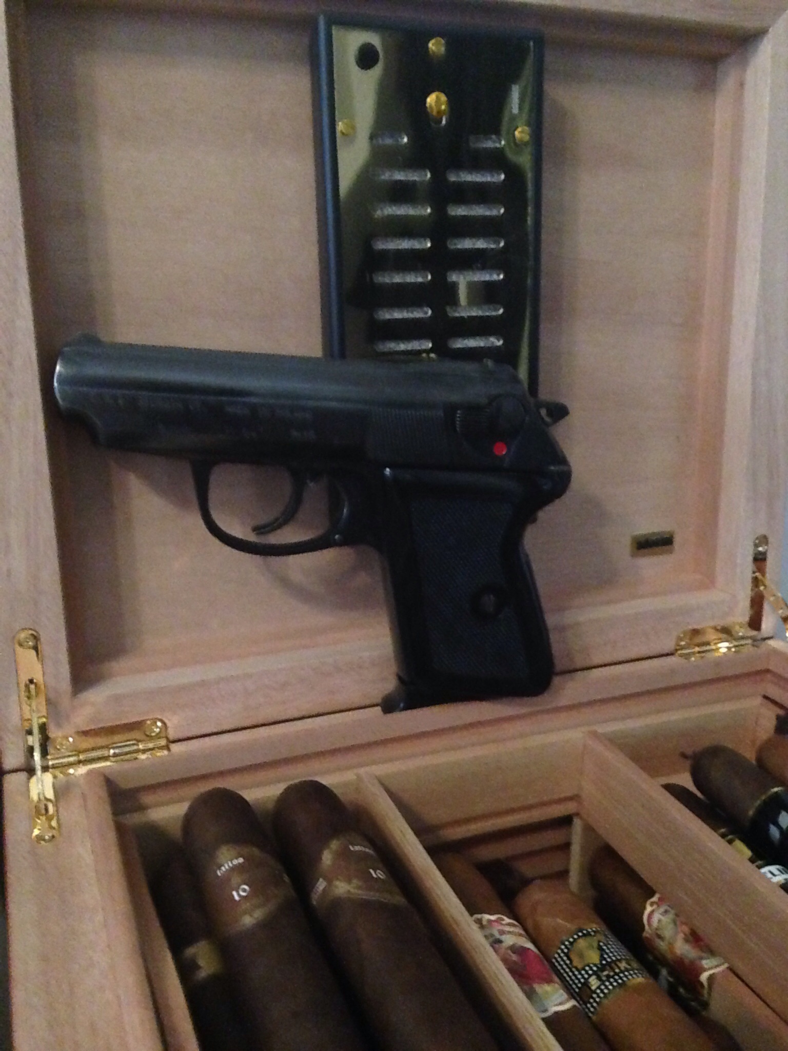

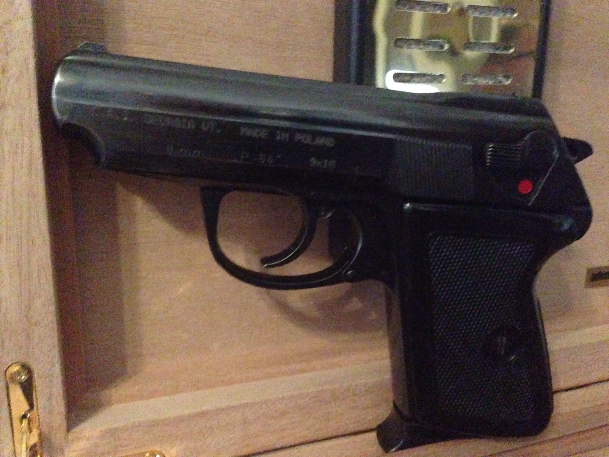

Hello All! :D I just acquired my first P64 (1976) yesterday and I'm very excited to have it and be here. It was imported by C.A.I. Obtained the pistol with an extra mag, but no holster, and 50 rounds of Silver Bear. Well, I decide to load up the magazine with the ammo to see how it all worked. I chambered a round, dropped the hammer with the safety, and then flipped the safety to fire. Then....nothing. The trigger just pulled as though the safety was still on. Hmmmm. I also have some A-Zoom snap caps and decided to give those a try. They worked just fine...had the crazy hard trigger pull that I expected!! :lol: Anybody have any thoughts why it was a no-go with the real ammo? Also, should there be some "play" with the hammer when loaded (with the safety either off or on)?

Here's a pic (I hope).

And another...
