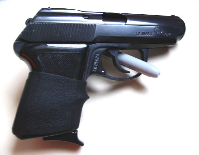

After reading several articles on flinching I sure do brace myself a bit more before I squeeze the trigger on the p64. I am so much more accurate with my other firearms because of comfort. I go into the shot feeling at ease with guns that I am use to.
And Curly1 thanks for the snap cap scenario ~ I will take that into consideration & I have bookmarked your link.
Thank you all for your comments, I will continue to learn this weapon & keep you informed.
By the way ... Meet the little brat ...
~ Say_What_Again
" Blessed is he who in the name of charity and good will shepherds the weak through the valley of darkness, for he is truly his brother's keeper and the finder of lost children. "
Re: Please help a frustrated Newbie
Sweet! I love gun porn! LOL
FWIW, I swapped the springs in mine, and it's a totally different gun. It's now my constant companion. Smooth as glass with plenty of snap. What a great little gun!
Yes that is a nice one Say What, round hammer too.
