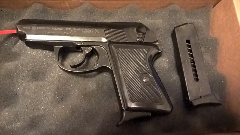

looks like it saw service but in great shape. not for sure though. heres a pic

Posts: 2539
Re: my p64 has a light da pull since i bought it
It's possible that if it saw service the owner at the time had some work done on it.
Nice example.

ya it sure has had the da trigger pull worked on its probably a 6 pound pull.

The original trigger spring with the ultra-high 28+# pull is a thick, black wire. Newer, lighter (as in the Wolff springs, at least) are a thinner wire and more silvery in color. You can easily see the spring if you take the grips off. This might give you a clue. See what's there, I suppose anything is possible. Who knows?

what do you guys think of the condition of the p-64 looking at the picture?

The external Bluing on the slide, near the muzzle of your p-64 is a lot better than mine. More wear on the trigger and trigger guard than mine. I just did a Wolff spring up grade on mine. the da pull is around 7 to 8 pounds (fish scale measurement), which is a bit heaver than yours. Over all, it looks like a great buy.
