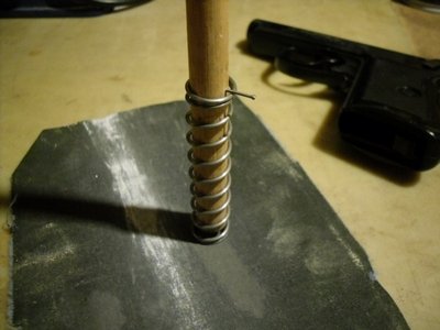

When I purchased the Wolf recoil spring a few months ago I had also thought the replacement spring could just drop in but I was wrong. No matter how hard I pulled the slide back I could not seat the slide. After a few hours of feeling short changed I decided to do some research and stumbled on this forum. With this great tip and about a hour in the basement I had a newly trimmed and perfect fitting recoil spring.
A cheap and easy solution to shorten the ends of the wolf recoil spring is to make a simple wooden sanding jig. All that is needed is a nail, emery cloth, and a small length of round doweling or square stock that can fit inside the recoil spring. I found out that if the spring protrudes beyond the dowel the tension when compressed does help to trim up the spring quickly and evenly. Here are a few photographs of the recoil spring before and after sanding and of the sanding jig.
Before sanding.
Before sanding.
After sanding.
After sanding.
Sanding jig.
Sanding jig.

Very clever device JB7748.
wyo-man
