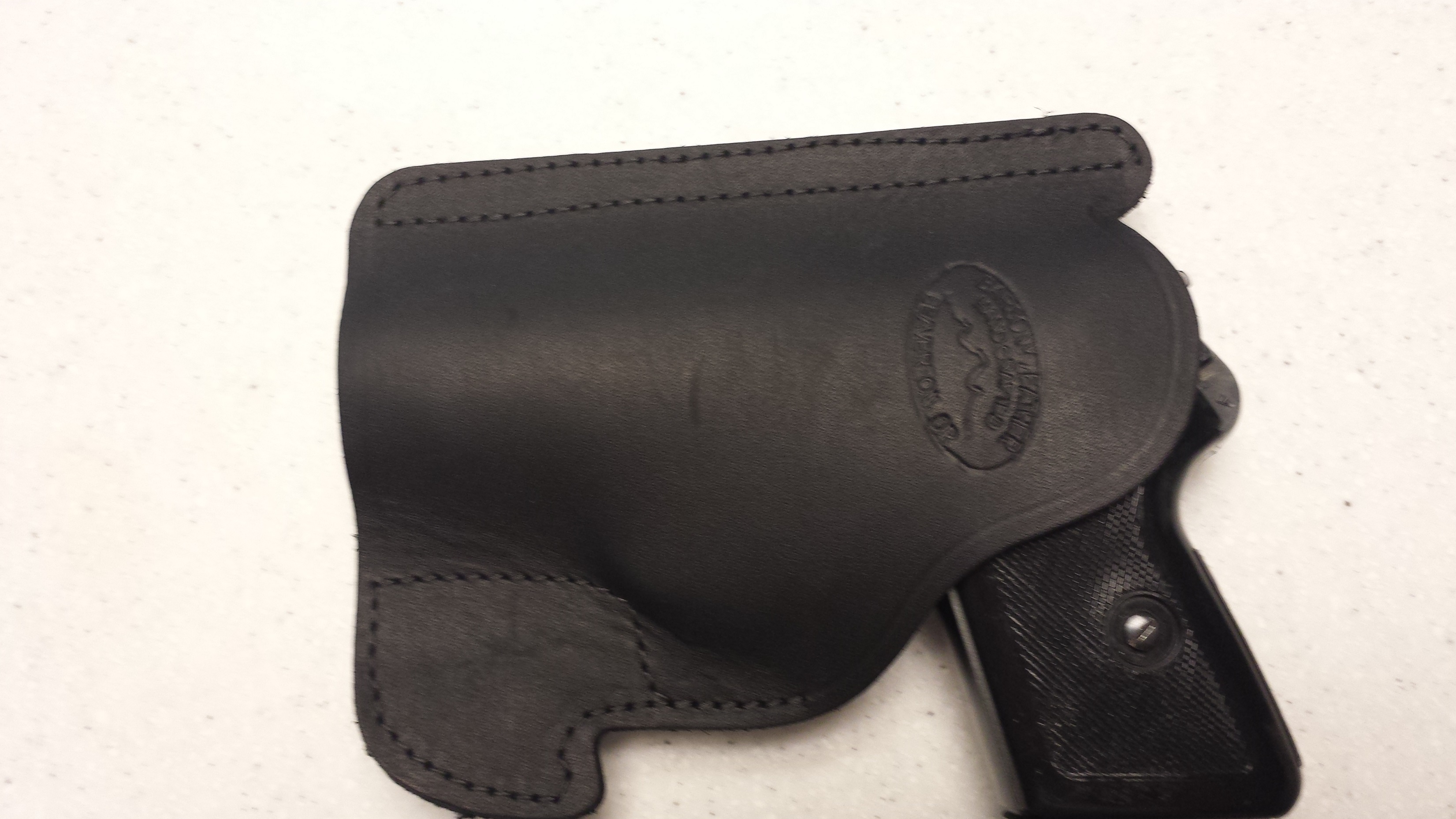

dmarbell wrote:I just received two Barsony holsters for my P-64: one leather pocket holster, and one nylon IWB right hand. Both work fine, and are pretty comfortable with this heavy little gun.
I'm not sure about the nylon holster yet, but the leather pocket holster seems perfect to sew a little nub in the upper part that would take the safety off as you draw the gun. This might be a factor of the leather being new, stiff, and not really broken in yet. Anyone ever tried it?
The leather pocket holster I got from them was really thin and way too soft to prevent printing. Can you put up a picture of yours? I'm curious to see if there's a variance in quality.

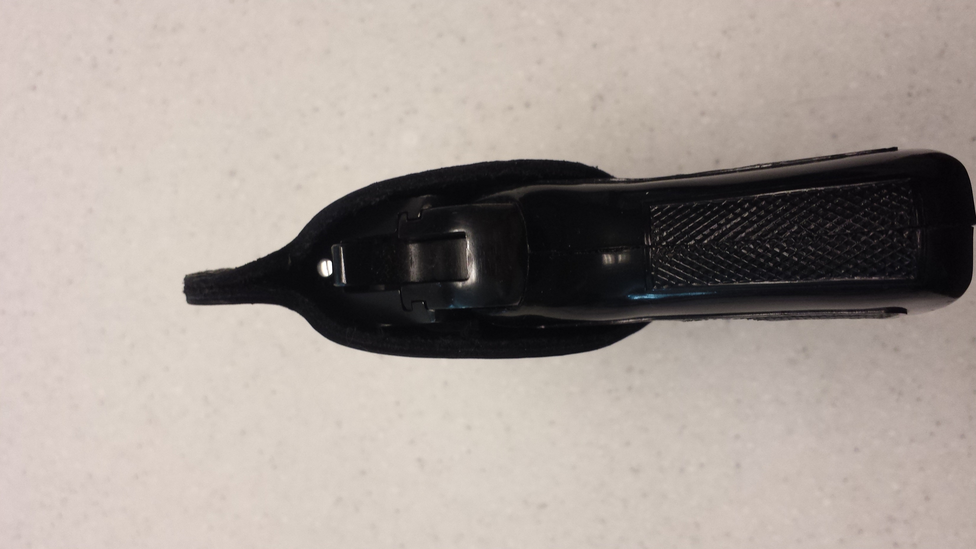

dmarbell
Posts: 12
Joined: August 26th, 2014, 9:39 pm
Re: P-64 and pocket carry
Post by dmarbell »
dmarbell
Posts: 12
Post by dmarbell »
Posted pics of Barsony PO49BL. Sorry about the pics, kind of hard to get without being outside. I might try again later.
I believe the leather is stiff enough that a nib would take off the safety, IF the holster stays in the pocket. As hardy as these safeties are, you might rip a pocket trying to pull the gun out of the holster.

@dmarbell Yeah, that pretty much looks like the one they sent me, except mine's brown. I would like to put a pin or other kind of reinforcement in it so it doesn't slide all the way in, as it's hard to draw otherwise. May also have to stitch a second leather "Square" to the side that faces out to keep from printing. Kinda like this one, which I should have bought in the first place.
