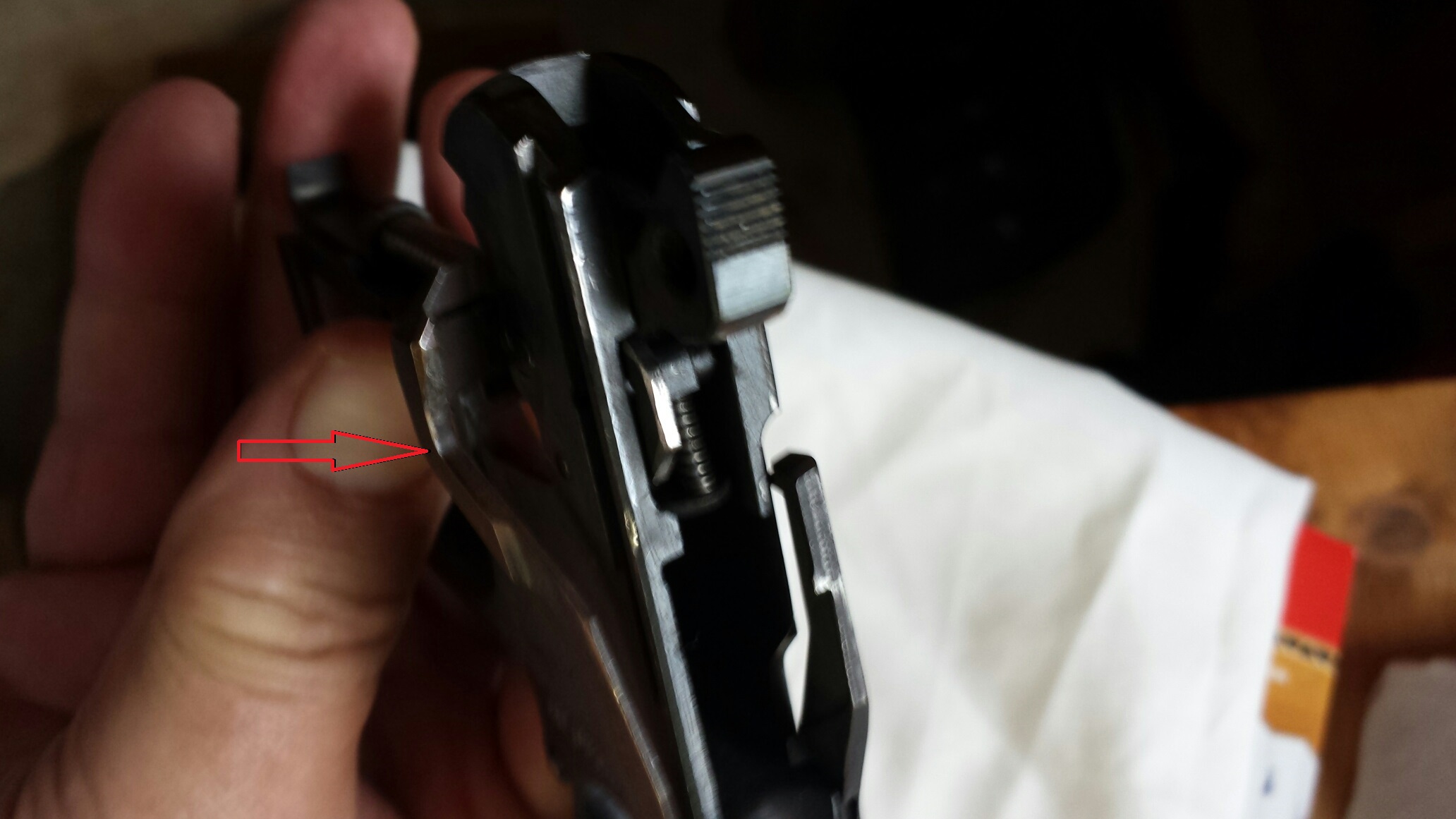

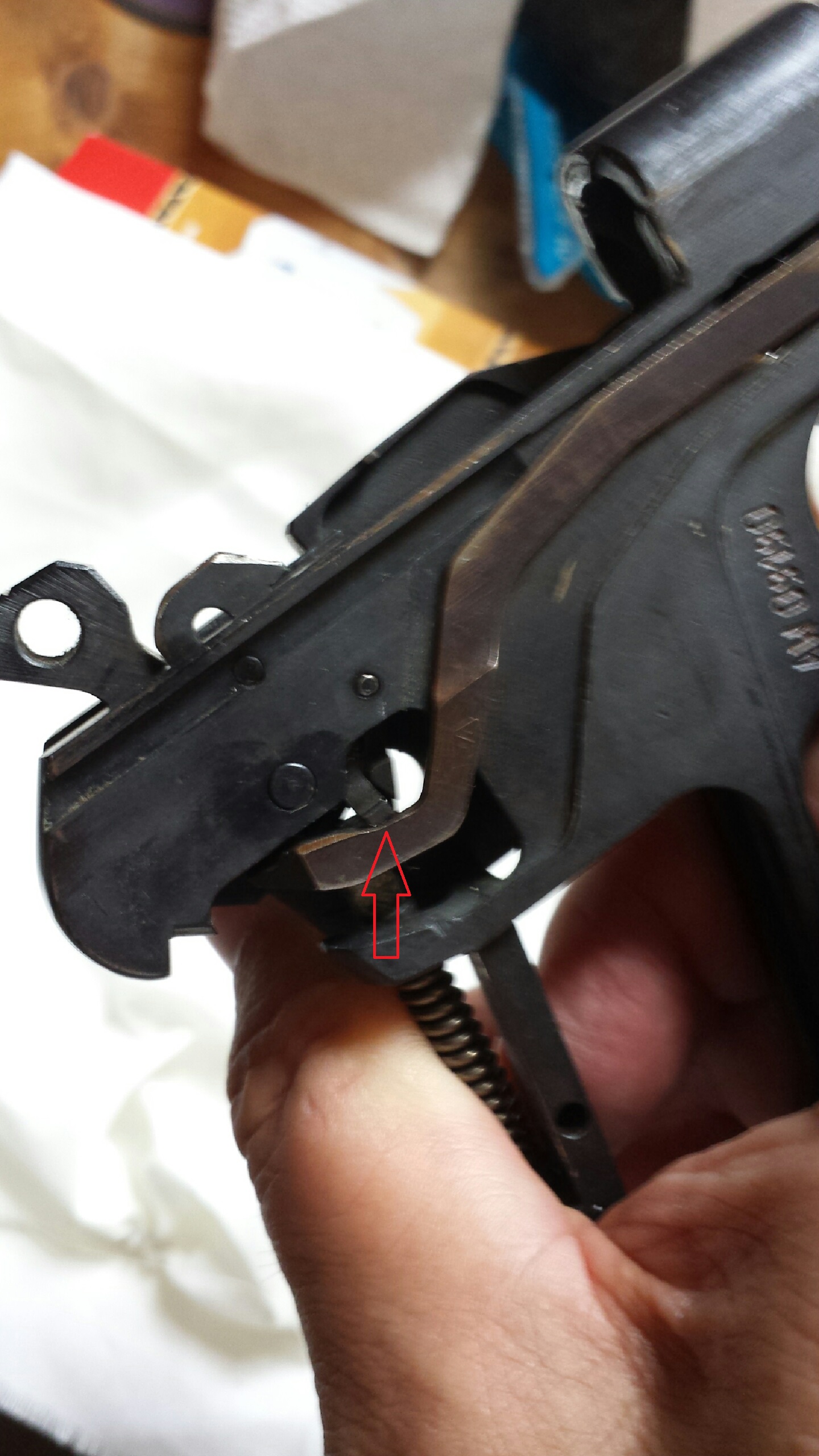

Be gentle, as I am a P-64 newbie. And I know this has been hashed and rehashed.
My DA trigger pull is hard, but seems to have a definite hard stop point just before it breaks. So, beyond the obvious spring replacement, I have these questions. (I have yet to shoot the gun, so I'm not ready to replace springs until I deem it absolutely necessary.)
It is recommended on here to fire the pistol a few hundred rounds to break it in. But does firing it break in the trigger and hammer action any more than dry firing? Will repeated dry firing wear in the action some, and make it smoother, if not less hard?
Next, I am posting two pics below. The arrows point to a contact point on the trigger bar, where the trigger bar contacts the disconnector. My trigger bar at this point is rough. At first, I thought the contact with the disconnector might be causing the hard stop feeling. But, upon further examination, it looks like the disconnector rides on the trigger bar without any real pressure. Is that right? I was going to use a drimmel and polish the trigger guard, but that looks like a waste of time.
Polish the Polish Trigger Guard! Sometimes puns are just too easy!
Danny
Re: DA Trigger Pull Question [Reprise]
Dan,
In theory you are correct about breaking it in. With use the springs will loosen up. However in the process you could break something. Never dry fire, always use snap caps to protect the firing pin from damage. Also keep in mind that these springs are heat treated and made to hold their elasticity. It would take a very long time firing the P-64 to get the hammer spring to loosen to a point where it is noticeable. These were made to be stiffer and harder hitting due to the stiffer primer sub-machine gun ammo they were made to use.
I recommend that after you fire you P-64 you still don't care for the double action, just get the variety pack and see which hammer spring works best for you. I use the 18lbder and have never had a problem with it.
In regards to the trigger bar vs the disconnector; The only really come into play during when you safety your P-64, and when it is out of battery. So the is not really an reason to polish the two. Also in doing so you could inadvertently ruin the disconnector.

All the friction comes from the hammer pivoting about its pin. This is because of the really high pressure exerted by the hammer spring. Weakening this spring not only makes the spring easier to compress (which lightens the pull, which is caused by a lower rotational torque of the hammer spring), it greatly reduces the friction from the spring jamming the hammer into the pin.
If you were to chamfer and polish the inside of the hammer and the outside of the hammer pin, it would probably make the biggest difference.
