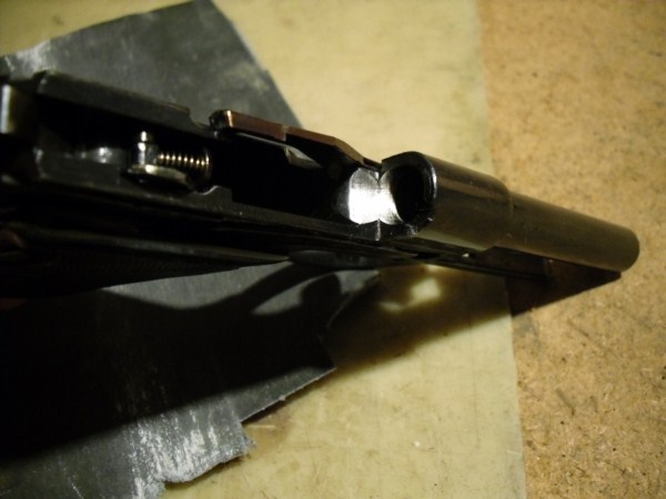

A suitable substitute for jewelers rouge for light polishing is regular old toothpaste. I used Colgate with baking soda on my P64 and a wet felt Dremel pad. Although it took a little longer it got the job done and had a minty smell throughout the whole process. After feeding through 150+ rounds I have had no feeding problems.
Results with toothpaste.

Brigade, looks like you did an excellent job on your feed ramp and chamber. I usually only will shoot around forty to fifty rounds with my P-64's, per shooting session, so I think I will leave mine alone. You did an great job though and your picture really explains it well. :mrgreen:
Those who beat their weapons into plows will do nothing, but till the soil for those who do not.

I use Flitz with a bullet shaped Dremel cone and a light touch on all my feed ramps. Nothing but good results. No offense to the OP but I think he might have gone a little overboard removing material at the transition between the feed ramp and chamber.
