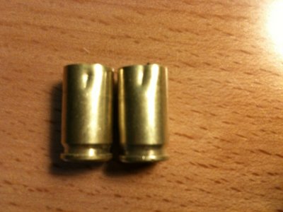

I've been working with the 116 grain Rim Rock hard cast bullets in my CZ-82. I am using cut down 9mm Luger brass. I worked up to 3.7 grains of w231 following in Frank's footsteps. I am having to load the 116 grain Rim Rock bullet to .955 to function properly in the CZ-82. They come out VERY accurate and VERY hot. Vigorous recoil. No pressure signs looking at the primer and case, and no blowback of unburned powder in my face. I am getting a consistent dent in the side of each of my cases at this load level, like the case is impacting the gun somehow on the way out. I don't normally get this with my plinking loads. I'll try to get a picture. I am running the extra power recoil spring from Wolff on my CZ-82.
I'm loading these .015 shorter than Frank was so that they chamber in the CZ-82. Also, by using cut down 9mm Luger brass instead of real Makarov brass I lose a little case volume. I'm tempted to try 3.8 grains of w231 but I'm conscious of the case volume issue, especially since I don't have a chrono. I may hunt up some Starline Mak brass at the next gun show.

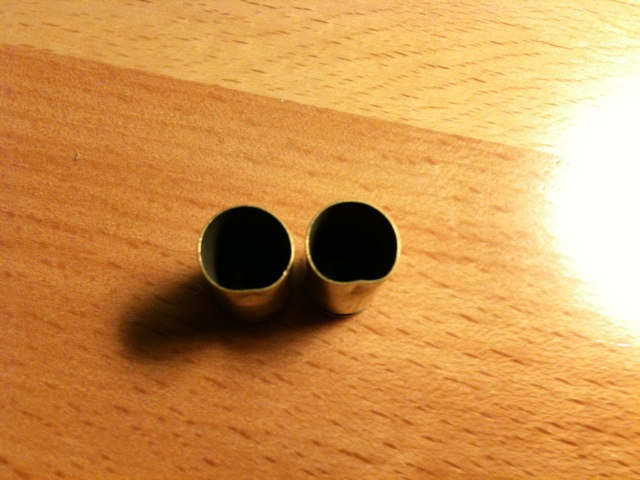

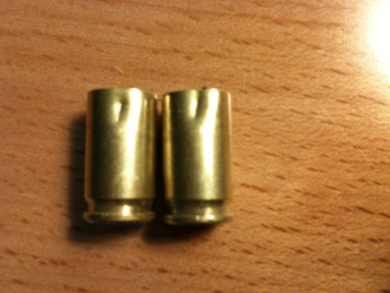

The consistent dent I am getting just below the mouth on my cases is definately the top edge of the extractor at the ejection port. It matches right up. The case is hitting the ejector with such force it is flipping around 160 degrees and the extractor is denting the case just below the mouth. I definately have some serious slide velocity going here, even with the extra power Wolff recoil spring.
Got a good pic of the dent.

I'm using the heaviest aftermarket recoil spring available for the CZ-82, an 18 lb Wolff spring. Stock is 14.5 lbs.
Not so much worried about the 'loss' of the brass from denting, just reading all the signs available since I don't have a chrono. Seems I'm getting some wicked high slide velocity.

I don't know why the CZ82 only takes a 18# recoil spring even the P64 can be had in a 22# spring. Makarov.com say it has a shorter slide surface than the PM Makarov but I don't know so I probably would back off of the 3.8 to say 3.6grs for your pistol. If you chrongraph it the fps ought to be pretty good anyway and no slide speed problems, just thinking.

Re: Final Range 116grs.
Data point: The chrono data from Buffalo Bore shows the CZ-82 running 43fps faster than the EG Makarov.
So interpolating against Frank's work, I may already be above 1000fps in the CZ-82 with 3.7 grains of w231. I don't think I'm going to try 3.8 grains without chrono-ing what I've already done.
Another data point: I took a close look at my range pick up brass that came out of my CZ-82 that was loaded with 4 grains w231 behind a 95 grain bullet (the Norm Sutton load). I consider this a relatively hot load. It feels quite snappy. What I found was a very slight denting in the cases, similar in form but much less pronounced than the dents in the picture above. Maybe I'll get some pics and post later.
So it is somewhat re-assuring to know I'm not WAY out there with the dents I'm getting in the brass. It isn't something new; It has occurred before, just less pronounced. Still, I suspect 3.7 grains w231 is the VERY top end for the CZ-82 if not a little over. Without a chrono I will probably run 3.6 grains for carry for the time being. Sure as snot I won't be plinking with it!

fish,
I used .970 as a COL and you used .955 as a COL. This could be reason you are getting more pressure than I did. 3.6 sounds like the best load for you.

The Rim Rock bullet doesn't feed reliably in the CZ-82 at any length longer than .955. The other bigger issue IMHO is the use of converted 9mm brass -vs- real Makarov brass. A while back I sized, fire formed, and filled two cases to the rim with powder, one converted the other real Mak. Weighed each. I was shocked at the weight difference. I need to go do that again and use Lee's VMD numbers to figure out actual volume difference.
I'm going to pick up some starline brass and try again.
