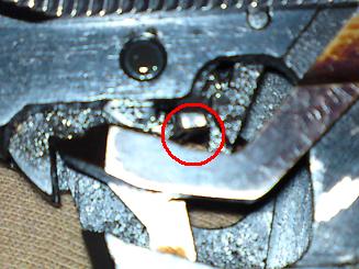

Re: Removing Slide
Posted: March 16th, 2010, 10:07 am
by juniustaylor
Those spots of wear seem very minute really. Hmmm. Your safety appears to be in pretty good condition. I'll have to give it more thought as to what could possibly cause your decocker function to work 50/50. On your disconnector where your arrow is pointed, that is a little ramp for the safety barrel to ride on so that it can be depressed into the frame to decock the hammer. That more than likely isn't wear. When I remove my slide I cocked my hammer back and pushed the disconnector in until the hammer released (supporting it with a free thumb so it wouldn't slam against the sear plunger and pin). Mine decocked when the top of the disconnector was about 1.5mm or so from the top of the frame. I'd have to try to precisely measure it, but that's using my calibrated eyes. :shock: What year of manufacture is your particular piece?
Some folks report little change when using the heavier spring while others report that it greatly improves the felt recoil. I bought the 20# spring because I was misinformed at the time. I read that the original ammo was some sort of 70-ish grain stuff and the heavier 95 grain ammo would have more recoil, so I bought the spring to keep from tearing the gun up. However, knowing now what I didn't know then, I really didn't need that spring - the 70 something grain ammo never existed. I have not shot the gun with the original spring, I should take it with me the next time I shoot it to see how the recoil feels.
I haven't heard any more word on the safeties and firing pins that Harrington is supposedly making. Guess we'll see when it happens. I would definitely jump on buying an extra firing pin and safety.
Junius

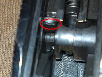

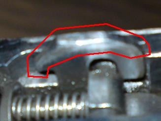

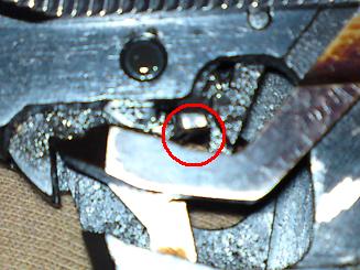

Re: Removing Slide
Posted: March 16th, 2010, 1:47 pm
by Weasel640
juniustaylor,
Sorry, those pics were not of my particular P-64, they were ones I found to use as examples of where the wear is. I've removed them to avoid confusion.
Here are some from my P-64. It has substantial holster wear on the finish so I suspect the culprit of the internal wear is years of the previous owner/user loading rounds while on safe. Thus causing the safety cam to violently slam forward into the disconnector.
Here is the wear on the safety cam, just behind the detent notch.
Here is the wear on the disconnector.
Lastly here is the spacing (with the slide on, fire selected) between the disconnector and the trigger bar.
It seems to me that there is just over 1mm of distance the disconnector has to travel before engaging the trigger bar. With this travel plus the amount of wear sustained during the service life of this pistol, these two parts will now fail if not lined up just right. Below are some solutions that I think will solve this or prevent it from getting worse.
1) Use as is with steps to prevent further wear ie: make sure these parts are always lubed, and only load rounds on fire, only using safety/decocker while slide will be stationary.
2) Modify the disconnector to close up the distance of travel, plus step one. This could be risky, if not done right it could worsen the action/function.
3) Replace one or both of the worn parts. This ideally would be the best solution however as there is a shortage of parts is less feasible.
For now I'll stick with step one as the pistol functions correctly as long as the recoil spring fits correctly.
