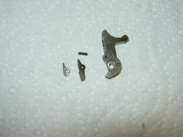

here are a couple of photos:

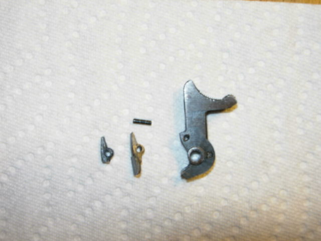

and another frontal view photo:
Re: p-83 double action problem
That does not look like a fun thing to mess around with.
Wow that original one sure does look broken. Snapped right in half. You hammer does look a good bit more worn than mine. If it was a well used P-83 there is no telling how many thousands of rounds have been put through it. Small parts like that brake over time/use. Glad you identified the problem and are getting it fixed. I really like mine too.

weasel640, when you had your hammer out, could you see the spring that was in between the sear and the hammer on your pistol. i want to make sure that there is one there.
frisbee2421 wrote:weasel640, when you had your hammer out, could you see the spring that was in between the sear and the hammer on your pistol. i want to make sure that there is one there.
Yes there was a spring in there. That sucks that it's taking this long to not get the right parts. You can see in my pics how at rest the hammer ratchet/Hammer Fly stays in the outward position. I'd use a punch in place of the hammer ratchet pin for testing/fitting. I'd start off eye balling where to trim by putting the spring in the hammer then inserting the punch through the hammer and have the ratchet on the punch but on the side so to see where the spring would line up. I'd give myself a little extra length of spring and slowly trim it down testing fit. You want it long enough to keep tension on the ratchet but not to much or to little. I think the spring is just longer than the thickness of the neck of the hammer.
