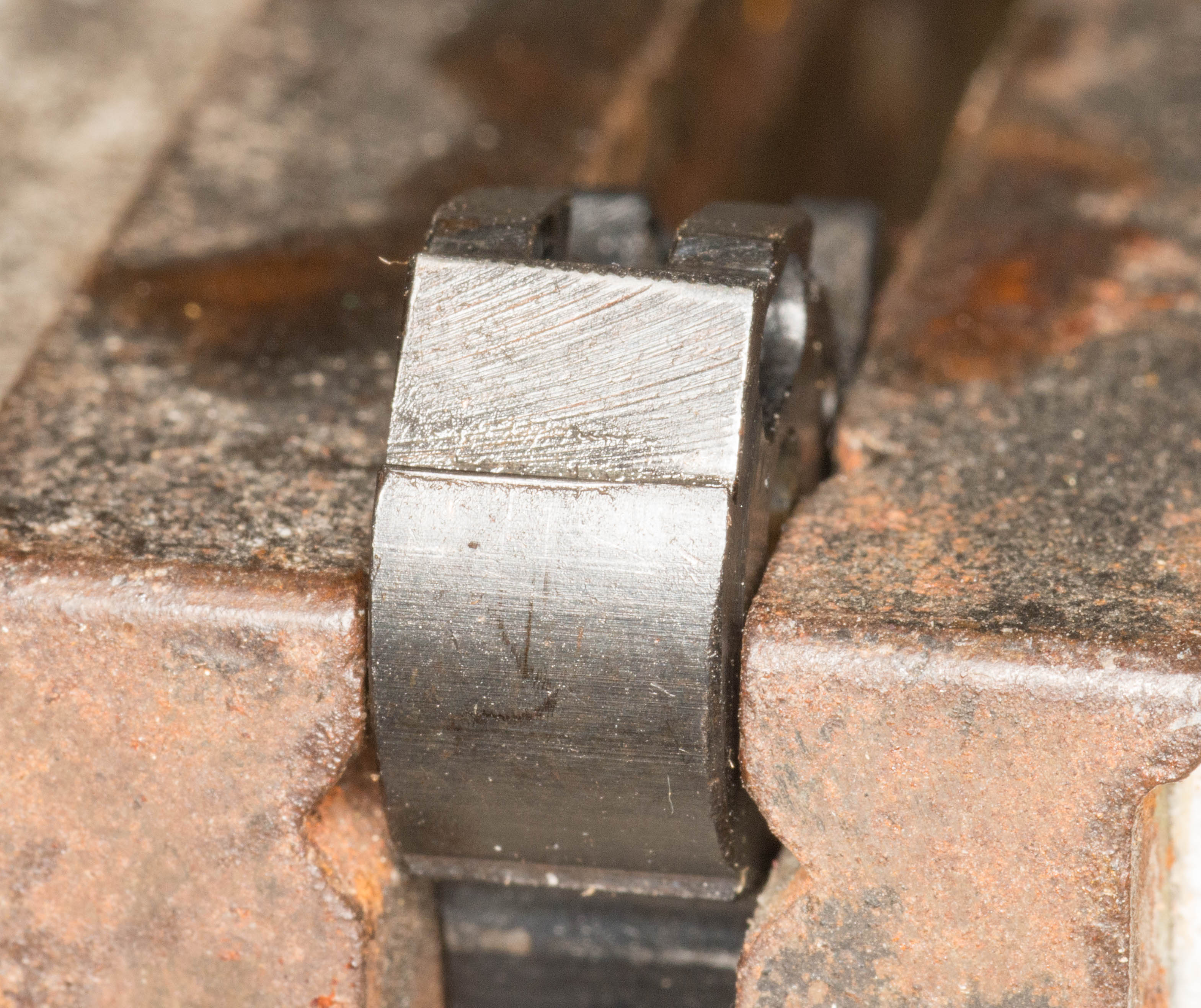

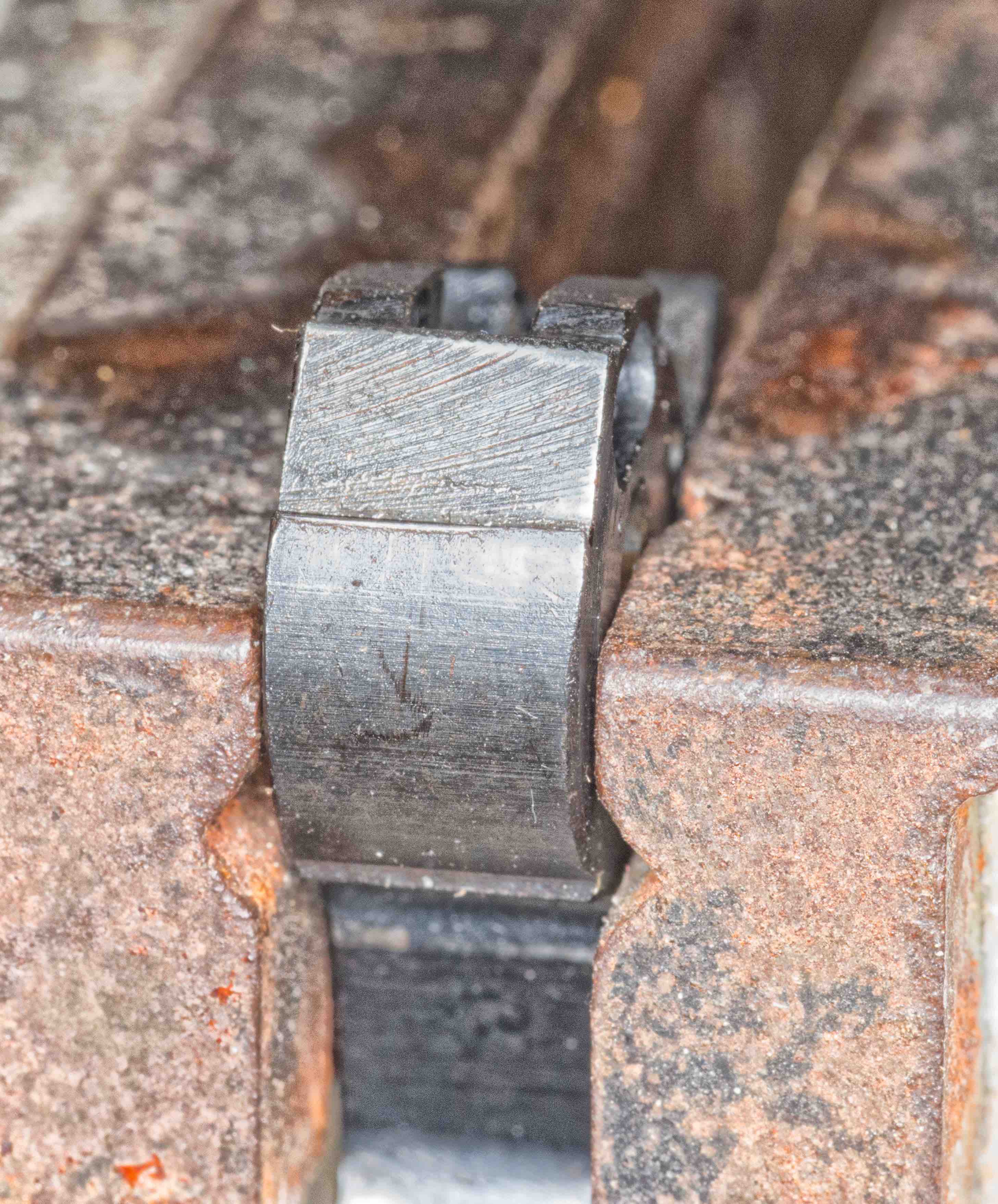

You are correct! The contact catches on the hammer where it engages the sear are way out of square and are not parallel to each other. If you look at the attached photos, you can see that the lower engagement point is uneven and the upper engagement slot is sloped down to the right.
The lower slot can be honed straight but the upper may be too far gone.

Are there any visible tool marks that would indicate a poorly attempted recut job?
Kotazo
Posts: 17
Joined: October 29th, 2017, 7:17 pm
Re: Please Help -- 1 oz SA trigger pull
Post by Kotazo »
I don't see any evidence of re-cutting. It almost seems as if the part was not properly hardened and has just been malformed from use.

The notch that matters the most is the bottom one. The top is the half-cocked position. I just noticed it looks a little like that slot was not cut completely to the end. I think it would be okay to square that one up since the half-cocked position is not critical to the firing of the gun. The bottom slot looks like an easy fix.
What does the sear look like?

The sear looks pretty good but I will be ordering a new one along with a "new" hammer if the repair works.
Since the half-cock is so deformed I am wondering if hammers were occasionally made with soft metal? Since I already have photos of the worn hammer and have my macro lens and strobe set up I will document honing the hammer and could post it if this works.

Honed the edge of the full cock notch and cleaned the edge of the sear. Reassembled the gun and took it outside to put 6 rounds through. Even though I barely removed any metal, the hammer would fall when the slide functioned after firing the first round but there was no detonation. The gun required a DA pull to set off the next round. Of the 6 rounds 4 required a DA pull and 2 fired on a controlled SA pull.
Glad I ordered a new hammer and a new sear.
