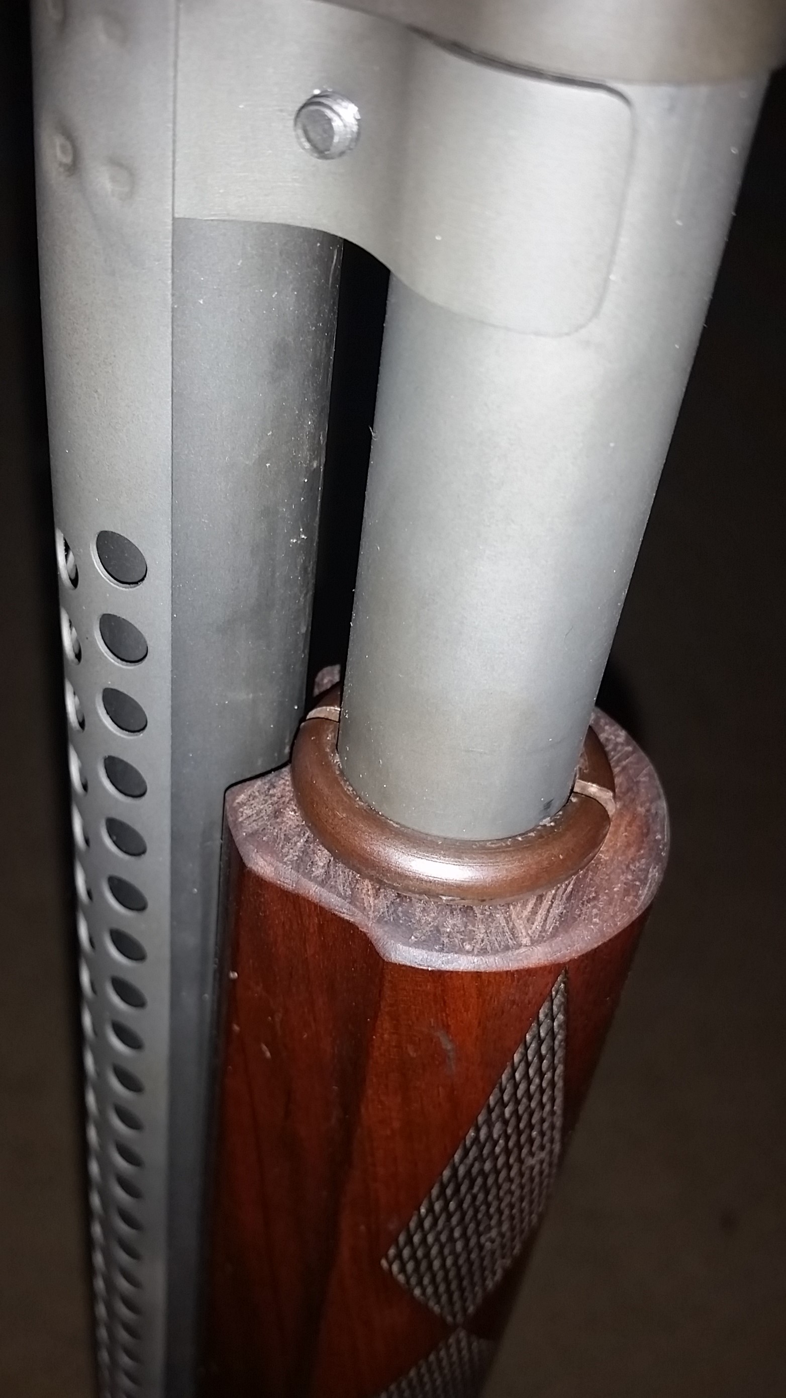

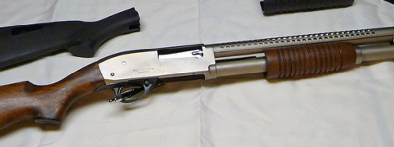

Just finished fitting a Flite King k121 stock set to my M5 (great little trench gun BTW).
The buttstock went on with little to no effort, the forend required inletting for the double action bars (Flite King was single bar).
Also, I had to cut around 2" off the muzzle end of the forearm, as the action tube is much shorter on the M5. I cut mine near-flush to preserve the checkering, so I ended up using the castle nut that came with the forend. Cut an extra 1/4" if you plan on using the M5 nut.
(Man, the camera really highlights my shoddy touchup job :lol: )
Final note: be very careful when removing the forend assembly, as the action bars can get tweaked, particularly the magazine stop side. Nothing that can't be straightened out, but an avoidable hassle.
