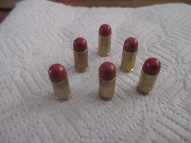

My first attempt with powder coated cast from the Lee mold. Tumbled in a plastic peanut butter jar, baked @350 degrees for 15 minutes on a foiled cookie sheet. It took 2 coats to get what I consider a satisfactory coating. I have yet to shoot them. I did flare them a bit more than usual. The Lee factory crimp die smoothed them out and they seem to chamber well. The red looks so appropriate, doesn't it?

Powder coating is applied as a lube. I normally use Alox and more recently an Alox/Johnsons floor wax combo. The Alox works very well: no leading whatsoever, but it does create more smoke and gums up my seating die somewhat. The powder coating is supposed to be good for higher velocity cast bullets in rifle calibers. Some are getting 2400 fps with no leading (using a gas check as well). There are several cast bullet makers (Missouri Bullet for one) that sells powder coated lead bullets.
I am a tinkerer and like to try new stuff. Being retired gives me the time. I could never afford the time to reload when I was still working. I call my reloading time "therapy". :D

I got the chance to test some loads today.
First was the powder coated 9mm Mak.
The good: NO smoke, same accuracy as fmj, no leading and no red paint in the barrel.
The not so good: Out of 24 rounds, I had 5 fail to feed. A nudge on the slide loaded 3 of them, the others I had to clear. I did see some red paint on the feed ramp. The ramp is kind of rough, but I never had any problems before the coated bullets. I think a polishing would help. I also think that extra .002 of paint needs to be sized after coating. I should order a sizing die anyway.
Second test went perfectly. 9mm Mak cast with a custom lube: 60% Lee Alox and 40% Johnson liquid floor wax.
All Good! No smoke, same accuracy, no leading and no stink from the Alox. This recipe does everything I was looking for. I now wonder, why bother with the powder coating?
I will probably work on some rifle loads with the powder coating down the road. For now, I am delighted with the 60/40. By the way, I got that recipe from the previously mentioned website. Good info there!
Mike

Update with the powder coated projectiles: I received my Lee custom sizer and loaded some more. Previously I was seating them right up next to the max OAL. This time I set them a little deeper with .2gr less powder. Results were terrific. No problems at all with 48 rounds sent downrange. I know it is a lot more time and energy, but I enjoy doing things a little different from the crowd (I rode Triumphs when everyone else had a Harley). :lol: :wink:
