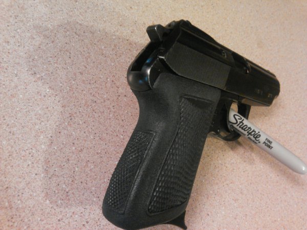

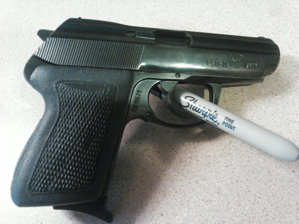

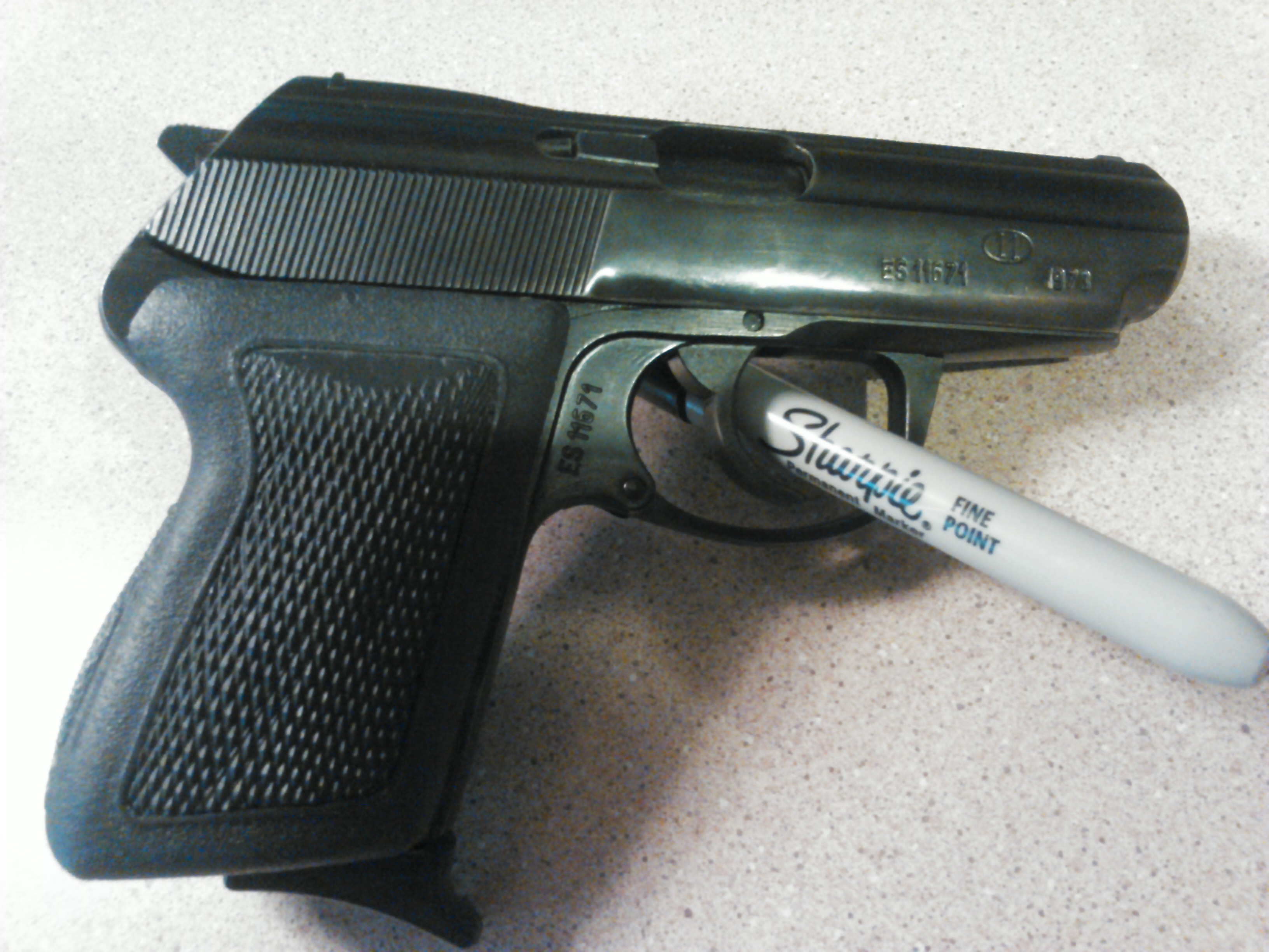

Received the grips today, did I little dremeling as Russ instructed and installed the new grips. Gotta say, the fit is very nice and they snapped into place without any problem. They feel real good in the hand wi5h the extra swell. Dry fired numerous times and all functions were normal. Will get to the range this weekend and try them out for real. So far so very good. Hopefully pics loaded

First thing I did was dremel down the top right side a little. Compare it to the original grip and you can see how it's basically cut out for the trigger bar. I just took it down a little to allow clearance for the trigger bar. Dry fire testing works fine. Live rounds this weekend
