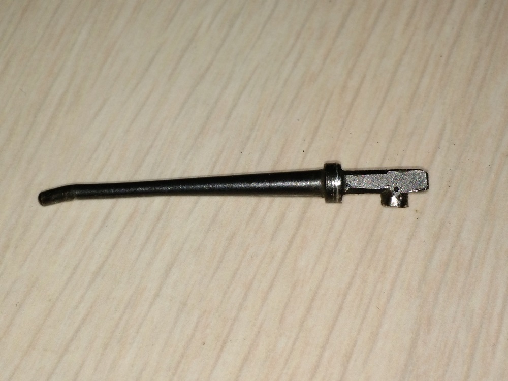

So I went out to do a little shooting today. I had the sights to check on my M&P, and test the function of the Vis35 project I'm working on. And I figured I would keep up with a little practice of my P64 seeing as its my primary carry. I loaded it up, racked the slide and noticed the slide didn't close all the way. The cartridge didn't strip from the mag completely. So I pull the mag, and rattle the cartridge out it. It looks fine, nothing odd about it. I look at the pistol and notice the safety is half way between the safe and fire position. So I put it in the fire position, put the mag in and rack it again and it fires immediately. That was a little weird. I notice the slide partially open again. So I again drop the mag and clear it. I notice the safety is back at half way. So I pull the slide and find this.
I have a number of guesses, but until I replace the firing pin I cant really test my theories. I will share with you what I find when I do. But I figured I would share.

Well there's your problem, it's bent! LOL!! :lol: Sorry everyone for what was possibly some misguided humor but that's the way my brain works see. Anyway, too bad this happened. I wonder what would bend it like that. Is your firing pin channel clear, no obstructions? All I can think is something got in the way of the pin when the hammer struck it and collapsed it, sort of.
Re: My P64 Let Me Down Today
That is odd, I could understand broken but bent is surely an interesting incident.
snailman153624
Posts: 291
Post by snailman153624 »
If it got stuck in the extended position, chambering the next round could bend it, as the rim of the next cartridge has to slide up against the breach face.
That looks to me like you broke a firing pin spring, and the pin didn't retract, basically. As you found out this can result in a slam fire. You're lucky you didn't slide in a whole mag full, or you would have fired off 6 rounds in full-auto.

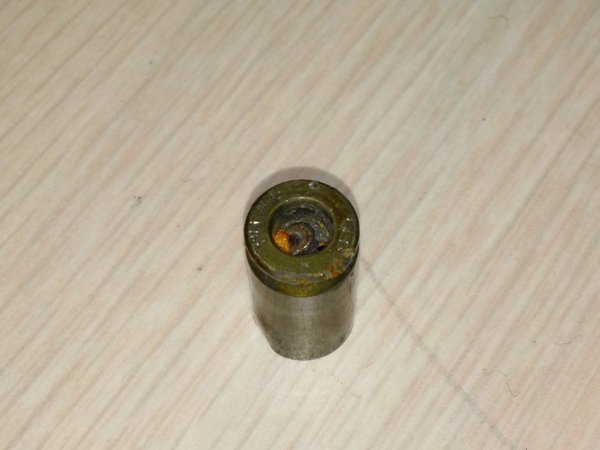

So after going through my brass, I found the one 9mm mak case from the day.
It looks to me the firing pin was being held out and when the slide closed it pushed the pin right through the primer and into the back of the case. If I would have been using brass boxer primed cases it might have been fine, other then the pin sticking out in the first place. But it looks like it came in and hit the anvil for the berdan primer which caused it to bend off to one side. There was nothing odd about disassemble, no odd debris to keep it from functioning correctly. It wasn't excessively dirty, so I'm still going to have to wait for a new pin before I can try to replicate what might have happened.

Here's a theory...maybe the pin pierced the primer and got stuck. When the round was ejected, it bent the pin.
If you have a stiff hammer spring and a thin primer, it could poke right through. The metal then grabs onto the firing pin, since when the pin tries to retract the metal squeezes down around it, wedging tighter.
Possibly snailman but unlikely. That round is steel cased, my bet is it is russian manufacture and to military specs I bet as well. And military ammo has a reputation for hard primers. If it was of Western manufacture ie; brass cased and boxer primed then I would say there is a better chance of that being the case. But the Russians did not change their manufacuring specs when they started marketing their extra ammo to the West and when it sold well they just kept the presses running so that is most likley a military spec primer. I vote for the broken or stuck firing pin spring that did not retract the pin before chambering the next round and bending it under the rim.

Everything checked out. Springs were good. Nothing missing, nothing jamming it up. I think it had something to do with the safety. But like I said I will be able to do more testing after getting the new pin.
