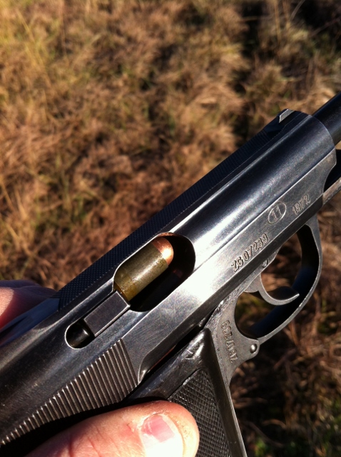

I have taken my 1972 P-64 to the range 3 times and all 3 times it has done the exact same thing. I have 2 magazines. The gun cycles through both magazines without any problems. After I reload the magazines the problems begin. The gun jams on the 3rd magazine. I have to release the magazine and then clear the jam. I load the same magazine and am able to finsih shooting. I then load the 4th magazine and it jams again.
I have read this forum since I started looking at purchasing on of these guns, so I followed advice and cleaned the heck of it and the magazines. I have used different ammunition each time I have gone to the range.
Any advice would be appreciated.

While shooting. Usually the 2nd round of the magazine. The picture above shows the jam after I shot 1 round from the 3rd magazine.

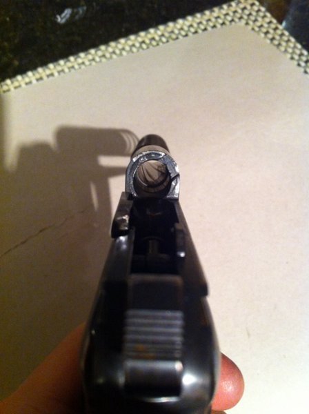

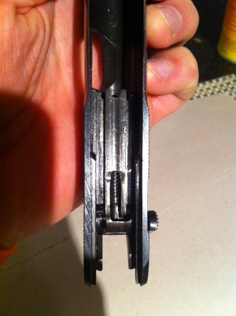

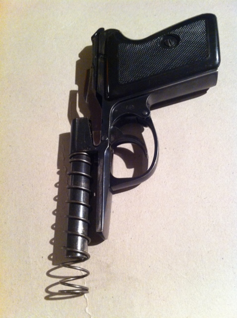

Have you changed the recoil spring at all? In the picture, it looks like extraction is happening, but the next round is getting caught up on the way into the chamber. Maybe the recoil spring is getting worn out and starts failing with use. Maybe there is something going on under the slide or around the chamber. Pictures of those areas might also help others in assisting you.

I have not changed anything on this gun since buying it. Here are some pics. Best I can do at night. I may be able to do better during the day.
Thanks again for any advice.

Post by kilbie »
Slide view

Chamber view

Are they the correct magazines for this year?
Also, I highly recommend polishing the feed ramp.

Just a theory - Are you using lacquered ammo? If so, it is possible the heat from the barrel (especially if rapid firing) is melting the coat and gumming-up the feed ramp.

Kilbie, welcome. I have had this issue a few times myself. What worked for me was disassembling the magazine, thoroughly cleaning the inside and then running a cotton ball with a few drops of oil on it through the magazine. these mags get really dirty really quick which is why I now clean mine every time I clean my weapon. Since I started doing that the problem disappeared. hope this helps. Stay safe.
