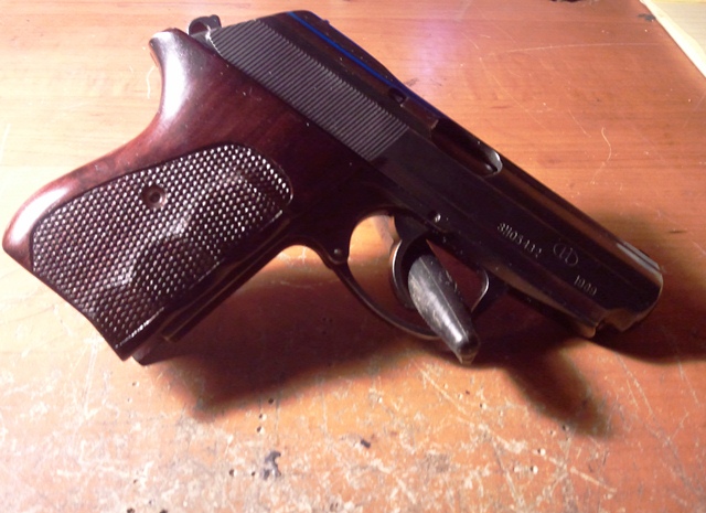

hi all, long time no post, i know this has been answered many times before but i would like to order the springs from wolf, and i just wanted to know what you guys are using in your p64s, this one is now my EDC so i want it to be the best it can be, now i know i can buy the spring kit with the 18,19,20# springs but i was really wondering what you guys use in yours and which recoil spring you use, i know that most of you it seems use the 22# recoil spring but wolf does offer a 24# spring as well, do you think it will keep recoil to a minimum or will it be to stiff to cycle? just want to get some input before ordering, all opnions are welcome

I have the 22lb and 17lb springs. Recoil is still on the snappy side.
I like those grips are they Marschals?
Re: springs again
yes they are. do you carry yours? if so what position do you leave the hammer in? decocked with safety on or in da? how does the trigger feel with the 17#
