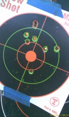

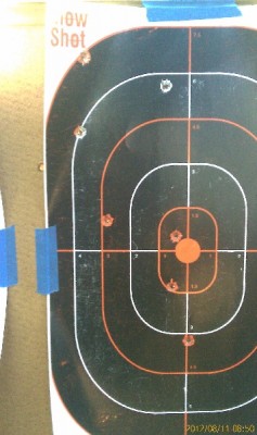

Photos taken with old cell phone on the spur of the moment.
Top photo is second magazine of 9mm that I ever shot in the Hi-Point C9, and first using my home cast 120gr bullets. The green ring is 4" diameter. Distance is 15 yards.
Second photo is first mag of normal name brand commercial 9mm Jacketed bullets in same gun at same distance. First time shooting the 9mm Hi-Point. Target is 16"x10". Jacketed bullets suck (or cast is great, take your pick).
