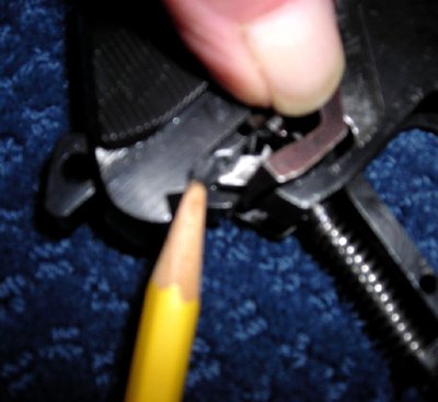

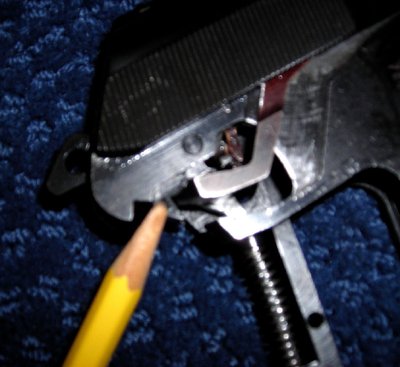

I posted some info above, but “discovered” more. While observing the beautiful mechanical ballet of the P-64 and still wondering about trigger bar load, I watched this happen on my above mentioned trigger slapper. The grips were off and the pistol was fully assembled but without the recoil spring as performing these observations is easier. I pulled back the hammer, no finger on the trigger, and watched the inside portion of the hammer that looks like the end of a claw hammer slowly come into the end of my trigger bar, make contact, and then began to load my trigger bar resulting in a BOWING trigger bar. With the hammer cocked it is close, but the load started when I began to retract the slide over the cocked hammer. I thought – this does not look right. My other P-64’s were close to doing this, but no cigar. On the others with the hammer back I could finger the trigger bar down and it would pop right back up. I had to check this slowly moving the slide over the cocked hammer and finger down the trigger bar to see if it was free. This is where no recoil spring installed makes this a joy to look at. I then thought—when does this happen except when cocking the pistol or racking the slide on a loaded mag? There is always room here if the trigger is depressed any amount because that action moves the trigger bar forwards. If firing with a trigger hold back this is not a concern here, but with a quick trigger let off I believe this could happen. This helped my former trigger slapper which is now the easiest on my finger. . The trigger bar end has contours to match its up and down movement with the hammer. I contoured in the end of my trigger bar. It did not take much to relieve it. I also deburred the contact area of the hammer. This is long winded, but I forget stuff. Now thanks to the Resource I can look back. Now for something lighter----- A friend asked me if my P-64 kicked much. I told him to make a fist, loosen your fingers up so that there is a hole all the way through, insert cartridge, place cigarette lighter to primer.
