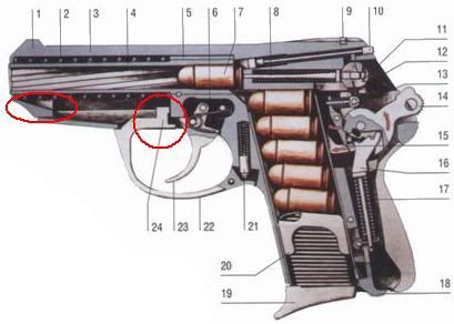

Sounds like the part of the trigger guard that comes up and blocks the slide from coming completely rearward during disassembly. That's why you have to pull the trigger guard down. Does anything on the slide look out of the ordinary. Check your trigger guard well and make sure that it looks complete. Other than that, I'm out of ideas, I'll have to check with my P-64 for any other ideas. Very interesting problem, never heard this one.
Re: Slide Popped Off My P64 During Firing
If you look at number 24 in this picture, that is the block that keeps the slide from coming back all the way except during disassembly when you pull the trigger guard down. This is the part of the trigger guard where the grooves are that hold against the frame to hold the trigger guard down when you go to remove the slide.
The other item circled is part of the slide. It's right below the muzzle and it is the part of the slide that butts against the stop (#24). This should keep the slide from coming all the way to the rear. Other than these, the only way I could see a slide being able to come off is if the parts of the slide and frame that hold each other together would have to be broken and that would be almost impossible.
Does your trigger guard have the stop piece still built onto it? No one has ground it off have they? I was looking at my P-64 and this is all that I can come up with.

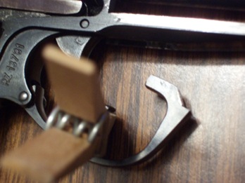

Better pictures. You can see the stop in this picture holding the trigger guard down.
In this picture, you can see the trigger guard is in its raised position and the stop would be blocking the slide from coming back too far. If you try installing a slide with the trigger guard up, you will never get it back on until you lower the trigger guard.
Are you able to put the slide back on without lowering the trigger guard?

Thanks juniustaylor, you nailed the problem right on. The stop broke right off and made such a clean break I could not find it until I saw your Photo.
I spoke with AIM today and they said they would exchange it with another P64 even though I'm 30 days past the 30 day warranty. AIM has always been great to work with. Thanks again, this is a great forum and website.
