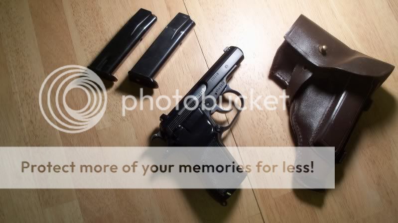

Took my little CZ-82 to the range today after I rebuilt and duracoated it again. Wasn't happy with the first rebuild. I didn't take it completely apart and I had blasting media in the workings. The little spring that controls the Automatic safety had gotten bent some how and the gun would fire double action only. I had replaced all the springs including this one. This little spring is a PITA :oops: to replace but I have gotten good at just removing the grips, main spring and ejector to give me access to it. Now the gun works the way it is supposed to. I need to get some extra slide stop springs to have on hand. CZ-USA sells a new version now and it won't fit my pistol without a hole drilled in the frame. I stuck a set of tritium night sights on the pistol too. Took the little Colt 1908 Novak Custom .380 for some play time too.

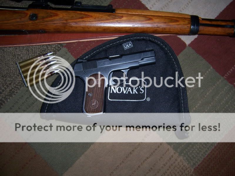

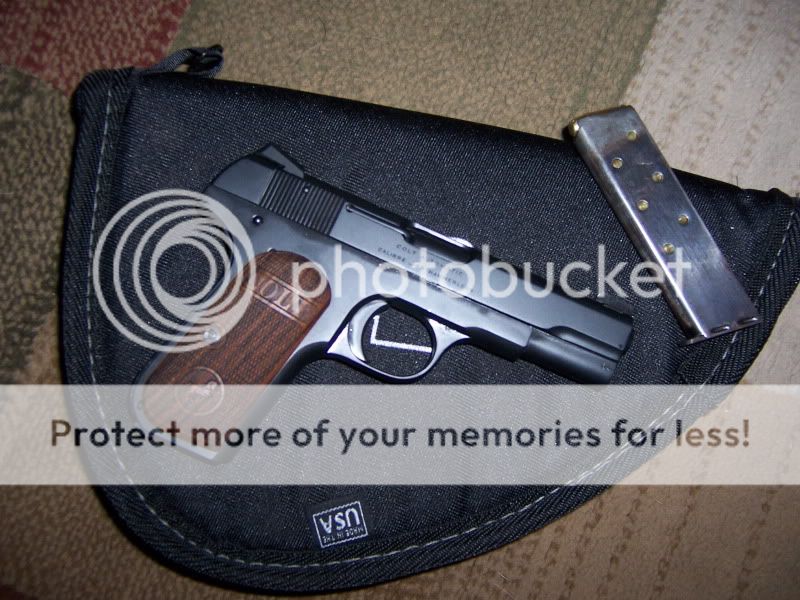

sapo
Posts: 68
Joined: January 8th, 2009, 2:05 am
Location: Tucson, Az
Re: CZ-82 Range Day
Post by sapo »
http://www.novaksights.com/products/sights/index.html
I had the little Colt for years and one day while shooting it the front sight started to work loose. I had a gun smith restake it but he didn't do too well of a job and in less than a box of ammo, it came loose for good. :shock: Now I had a gun without a front sight, good luck finding one. I had seen one on line that Novak did so I sent mine in. They bead blasted it, reblued and dovetailed the slide for the sights. Installed new springs. I like it, don't plan on getting rid of it. As a collectors piece, it may have had some value but as a shooter for me, it has more. It wasn't 100%. Maybe 80%. Some of the bluing was worn, it had small fine scratches, the grip safety bluing was almost gone. I have its smaller brother too. The grips I found on line. Better to shoot it than let it be a safe queen.
