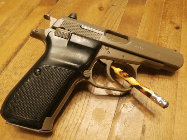

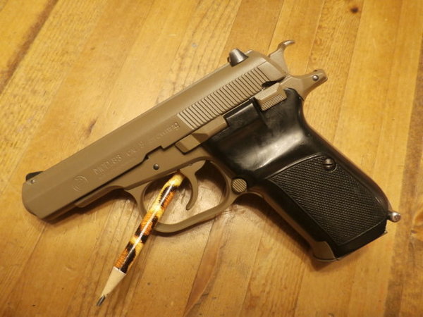

The media you use for blasting depends in part on the finish you intend to apply.
I just refinished a couple of CZ-82's using Duracoat. I used glass beads to blast them despite the Duracoat instructions that state that glass beads are not recommended because they tend to polish the surface; so the finish doesn't stay on as well as if you had a light "tooth" to the surface. Duracoat recommends aluminum oxide blasting media.
Duracoat's instructions are correct. After firing 100 rounds through the first pistol I refinished, I had finish flaking off of the "hard edges".
I re-blasted with aluminum oxide, and you could clearly see a difference in the surface of the bare metal as compared to glass beads. The finish on the re-blasted surfaces has held up perfectly for 400 rounds so far.
Fortunately, when you're doing the work yourself on your own pistols, trial and error costs you mostly your own time...
