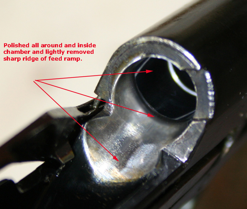

I have many P-64's and noticed that with the Silver Bear JHP I would have a feeding problem when I have fired almost 200rds consecutively within about a 30 minute time period. I have never had this happen with any of my P-64's with less than 150rds through them. So I do believe that the weapon is solidly reliable but due to the size of it I think that the overwhelming carbon build up when I got close to 200rds was too much for that many rounds consecutively. The round that jammed was 2/3 of the way inside the chamber but needed a little "forward assist" to get the bullet/slide all the way seated forward in order to fire it. I believe that with the new stronger recoil spring and also removing slightly with dremel polishing the feed ramp (reducing forward inertia) and also polishing the inside of the chamber all around will keep the area a little more open to allow for more tolerance of carbon build up since not only is the area slick and polished but a tad bit more open around the cartridge but not too much to allow proper blow back operation. Here is a photo after wards Image

Nice job! What specifically did you use to polish with? Is there a dremmel attachment with something like jewelers rouge or what. I ask because I recall reading a thread that someone else was also polishing the feed ramp and it was suggested that once they dremmel or file it to polish out any fine lines to be as smooth as possible. I'd be afraid that I do more damage than good!

I used a dremel attachment so I can get in close with an attachment hard cotton round polishing wheel with jewelers compound and removed the sharp edge at the top of the feed ramp and around the sides and on the inside of the chamber. No you are not removing that much metal in fact barely visible but inevitably by polishing you are removing minimal amount it will not hurt anything and then you will insure positive feeding even if the gun is dirty. A buddy of mine is in Iraq and carries this as a backup gun (ankle holster) and having the gun polished that way will give him more peace of mind if it isn't perfectly clean. I fired 200 rounds today for the second time and no trouble with feeding jhp. Do what you want but I didn't use to be able to fire more than 150 before I had trouble. Most custom guns makers practice this and I promise you that having a highly polished feed ramp is not contraindicated by anyone I know.

Polishing the feed ramp is an easy fix for increased reliability. Some pistols even need the bottom edge of the feedramp filed a bit. But I would not polish around or inside the chamber. The cartridge swells inside the chamber and seals gases to enable the blowback operation. I don't want a slippery chamber, or one that's even slightly enlarged.
