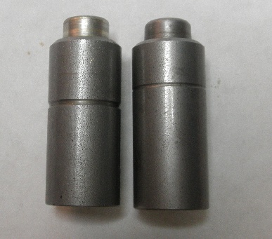

You may want to check your 9x18 expander die and/or the plug and verify it against your 9mm Luger if you have one. It may be possible for Lee to have goofed and put the Luger expander or plug in the 9x18 set. That "may" cause enough issue for the mouth to not flare enough.

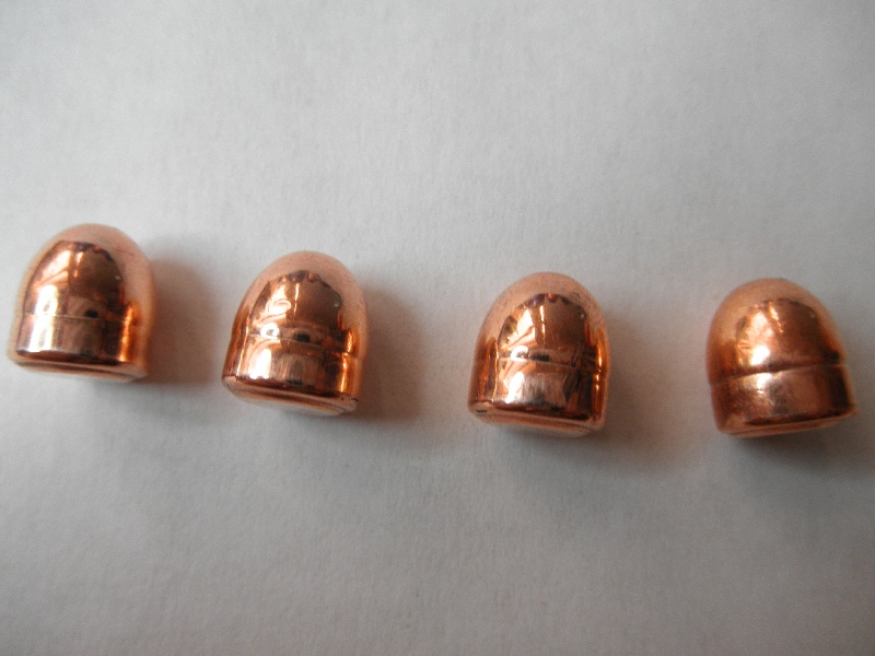

I made a picture and put in the measurements. Something to note is that my Lee 9x18 expander has a ring around the middle circumference. Not sure if they do this on purpose in the factory to make sure that only the 9x18 expander gets into the 9x18 die. Anyway, here is my picture and the measurements. Another measurement to note is the length of the expander plug. The 9mm Luger is 1.376" and the 9x18 Mak is 1.423". Mak is longer to account for the ~1mm shorter case.

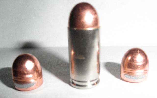

More issues. Besides the bullets sometimes going in crooked, tearing the plating, I now see the seating/crimp die is leaving a mark midway down the cases horizontally when I crimp enough to leave a slight perfect impression in plating. This is always in the same spot. Well below seated bullet depth. If I rotate the round and crimp a second time, a second horizontal line appears. It almost looks as if the die is resizing the finished round, if you are familiar with the LFC dies, which this is not. I have taken apart dies and cleaned with steel wool, but they looked fine, and this didn't help as crease is still there, exact same spot. (see photo below)
Also, I can get bullets to seat squarely almost 100% of the time if after initial flaring of mouth, I rotate case 45 degrees, flare again, and repeat this rotate flare a few times. This seems to make the flare more consistent (I guess), which allows the bullet a little extra room to adjust during seating.

Sorry about the photo below not being clear. Sun not yet up so poor lighting.
Photo of damaged bullets and crease in case of good round

Only time I got a mark like that on a case was if I started the case into the bullet seater die crooked. It would catch on the bottom of the die and put a groove like that on the case.
Certainly give the new die set a try and see what happens. This is a strange issue. I haven't read of anyone have this many problems loading freshly converted Luger brass.
