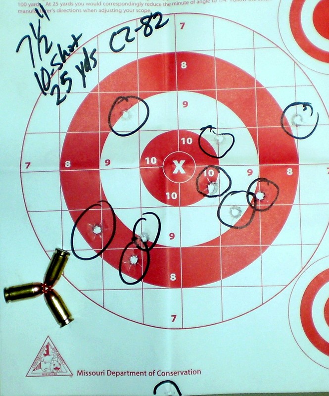

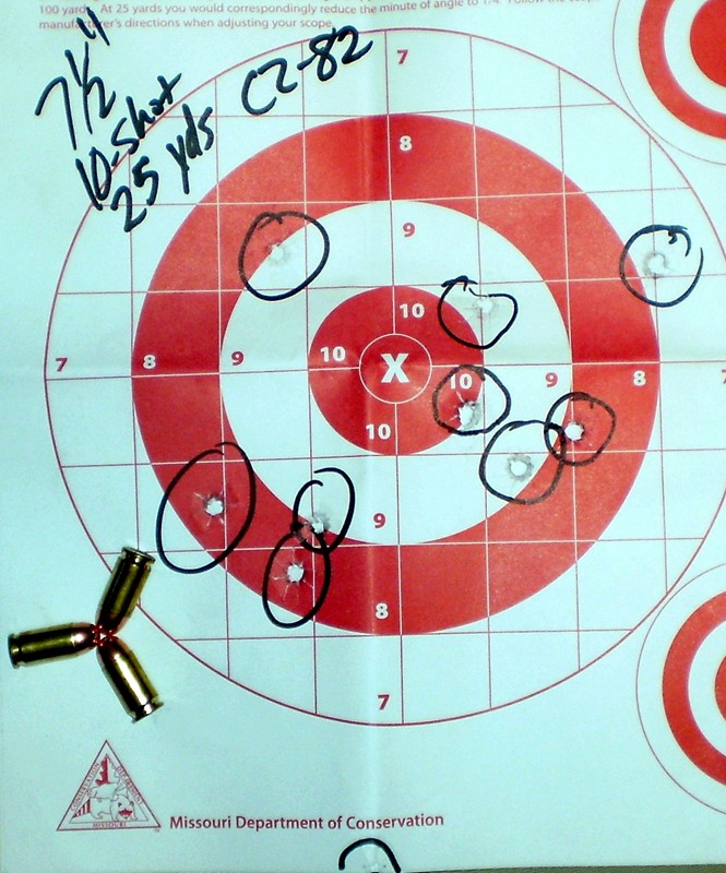

Posts: 1408
Re: post some your pet 9 X 18 loads
Post by juniustaylor » September 9th, 2010, 12:04 pm
Bullet: Berry's Mfg. 95gr Plated
Case: Federal 9mm Luger cut down
Powder: 4.6gr Power Pistol
Primer: CCI #500
Gun: CZ-82
Special notes: OAL on these is 0.975". Chambered and extracted good, no hangups. I shot these at 25 yards and had one oddball that hit a bit low which opened a 10-shot group to 7.5". I guess I had anticipated recoil and let the muzzle drop. Had I not had that random one, the group size would have been 5". That was 25 yards, semi-supported. I'll try it again with a better rest and see if my results can improve. I did not get to chronograph them, but the data showed it should be 1010 fps. I'll verify that later as well. I feel these were fun, accurate, and had some snap.
I will also add that these shot WAY better than Silver Bear from my CZ. I tried both Silver Bear FMJ and HP and they were terrible from that gun, pretty much went all over the place at 25 yards. I even had a pretty bad flyer that almost took out my friend's target paper roll. We laughed about it, but it was very crappy accuracy to the point of being not fun to shoot.

Jun
good report
